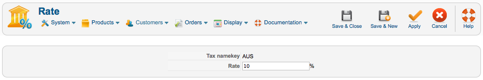

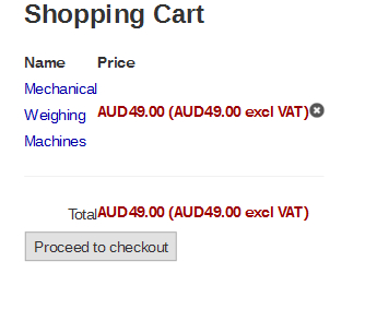

I've replaced VAT with GST in every instance I can find in the language file (English- United Kingdom) however TOTAL with VAT still appears in the order creation & order confirmation emails. How can I change this?
Also, GST is listed as AUS in the checkout..
Total AUD 4.25
Shipping AUD 1.70
AUS AUD 0.39
Final total AUD 5.95
Can this be changed as well?

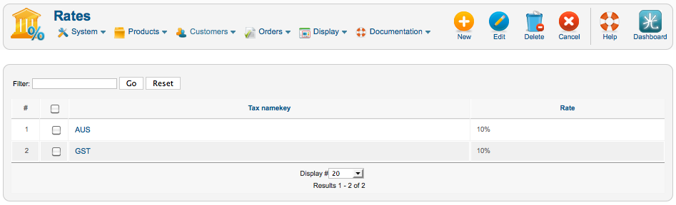

13 years 7 months ago #87752
1. tjharvey was right but this feature require the business version of Hikashop
2.

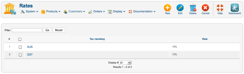

My solution would be to :
- Go to "Hikashop->System->Taxes->'Manage rates'"
- Create a new rate with the name "GST" and the same rate as your "AUS" rate
- Apply this new rate to your tax.
Hope this will help you.

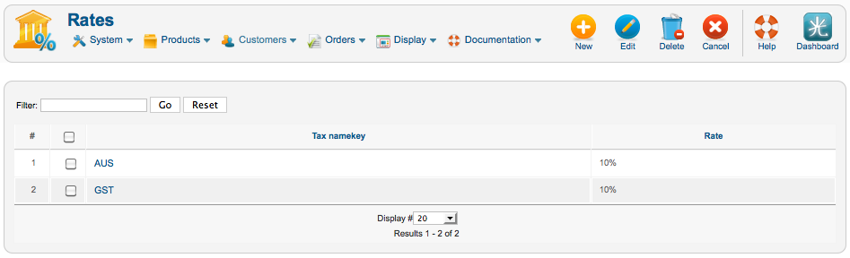

  • Posts: 42
13 years 7 months ago #87757
Thank you both for replying.

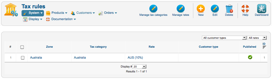

I have created the new rate but I'm having trouble applying it to the tax.
I goto system->taxes->
but none of the options (zone, tax category, rate) allows me to select the new rate
13 years 7 months ago #87772

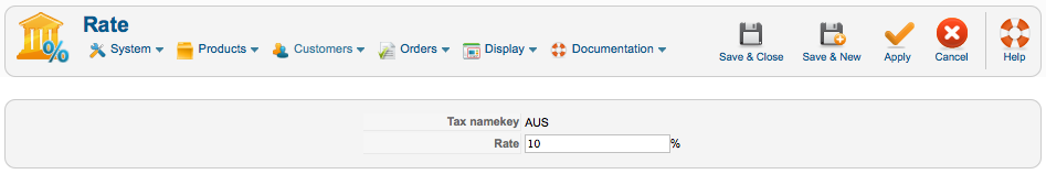

The rate option should allow you to select your new rate, can you show me screenshots of how did you configured your new rate and of all the choices of the rate option through your tax edition page ?

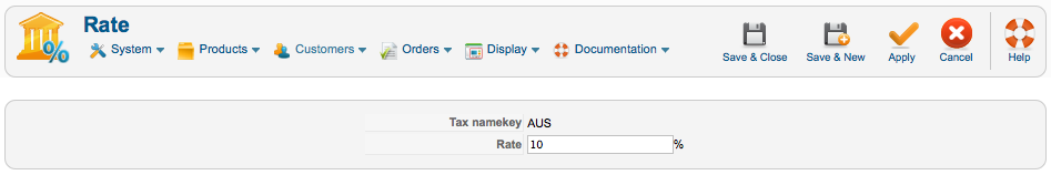

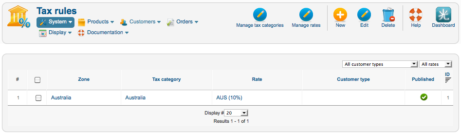

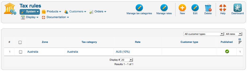

  • Posts: 42
13 years 7 months ago #87865
Hikashop>System>Taxes>Manage rates
none of these 3 options - zone, tax category, rate - allows me to set the new rate
Hikashop>System>Taxes>Rate
the rate option allows me to set a new % rate, but not select the GST rate I created

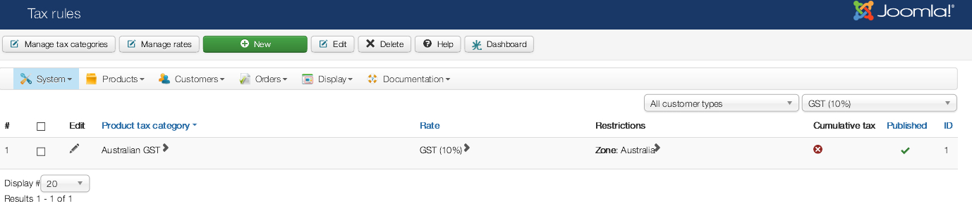

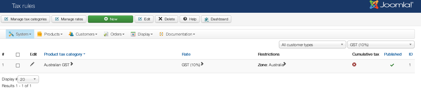

  • Posts: 42
13 years 7 months ago #87882
OK, I didn't realize I needed to create a new Tax Rule as well (I was trying to apply the new Rate to the existing Tax Rule).
It has solved the issue of AUS appearing in checkout process, however I'm still getting VAT in the email notifications...

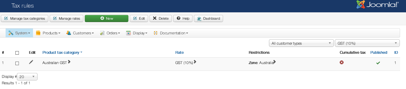

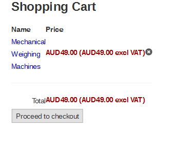

  • Posts: 21
10 years 4 months ago #236177
info@flashpoint.net.au wrote: OK, I didn't realize I needed to create a new Tax Rule as well (I was trying to apply the new Rate to the existing Tax Rule).
AUD 4.25 1 AUD 4.25
Shipping method : AUD 1.70
GST : AUD 0.39
TOTAL with VAT : AUD 5.95

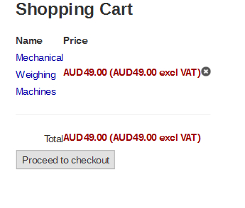

I have the same need to replace VAT with GST. I have created a new rate called GST and a new rule called Australian GST but I still get VAT in checkout.Iam not sure how to link the rate with the rule! I'm missing something here but not sure what!
My checkout display is also not what I want it to be.....I would like it to be as above....any help with this is welcome.

  • Posts: 21
10 years 4 months ago #236291
Thanks Nicholas... I managed to get a solution by following the steps posted by JIK (post #99445 - see below). The thing I missed was:" Product tax category = Default Tax Category" ! I had set up a new category whoich was not required. Also the Default Tax Category needs to be published - obvious but easily overlooked when panicking :)
I will modify the language file as per your instructions to amend VAT to GST in emails etc.
It looks as though your products are not picking up the GST at all.
Things to check:
Make sure Australia is published as a tax zone (System > Configuration > Zones)
Set the main tax zone to Australia (System > Configuration > Taxes)
Create a tax rate with tax namekey as "GST" with a rate of 10% (System > Configuration > Taxes > Manage Rates)
Create a tax rule for Australia (System > Taxes > New) where:
Rate = GST (10%)
Zone = Australia
Test a product to see if the tax is actually being recognised by putting in a Price with tax on the product edit page and then clicking into the Price box which should then auto calc the pre tax price.
May help.
