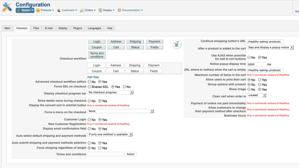

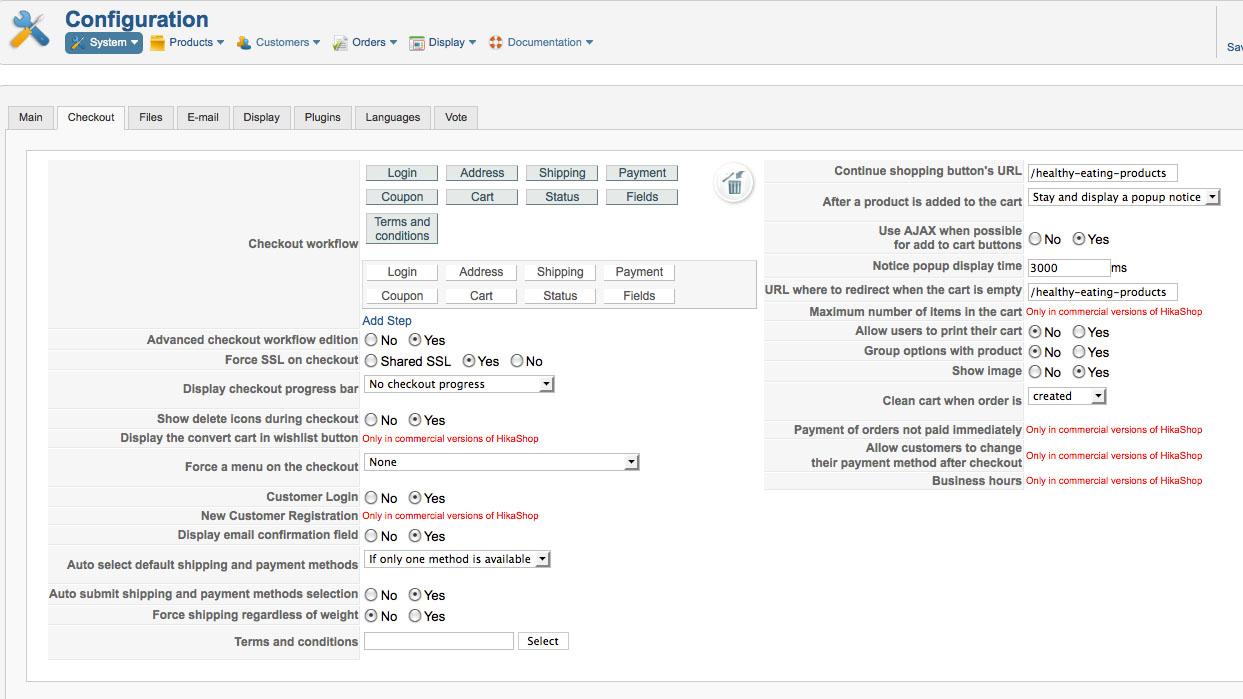

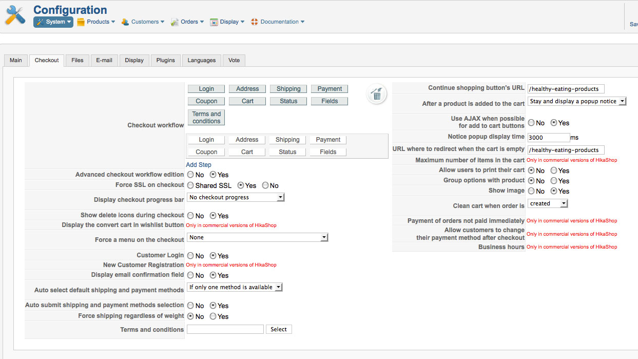

13 years 7 months ago #88164
Payment and Coupon are after login. See the screen shot.
  • Posts: 109
13 years 7 months ago #88165
My attachment was a .tiff and it doesn't look like it went. Here's a .jpg of it.
13 years 7 months ago #88167
You should use the "add step" button, and put payment and coupon in a different step than login's step.
  • Posts: 109
13 years 7 months ago #88187
Ah. Didn't understand how that workflow worked. Great! Thank you for you help.
