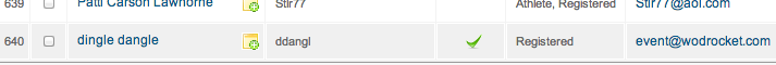

I am trying to ensure users are added to a specific user group after purchase. I have "User Group After Purchase" set to "custom" "athlete" group
but it does not seem to activate as seen here ("registered" but not "Athlete"):

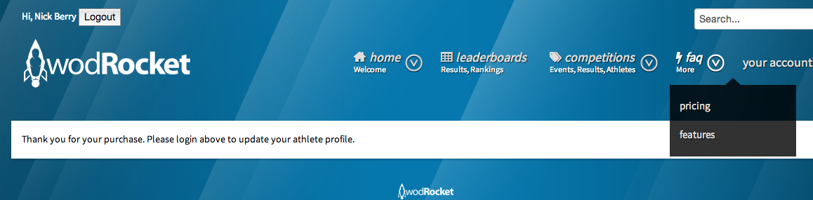

After creating new account and completing purchase, it still shows user as logged in (even though they are not) as evidenced by refreshing screen.
I have attached the screenshot. Many thanks.
