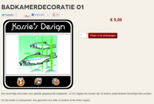

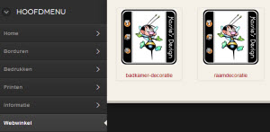

I am still struggling with how to adjust the layouts. I know i have to adjust CSS and/or the views. But especially finding out which view to adjust is a bit hard for me.
What i made so far is a default setup. Installed Joomla 3 and then Hikashop Business, the latest version :)
Made a menuentry that when clicked gives list of the categories (2 in this example).
(see hk01.jpg)

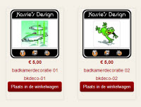

When clicking one categorie it gives a list of products.
(see hk02.jpg)
When clicking one product it gives a detailed view.
(see hk03.jpg)
My questions i have so far are these:
- how can i place in the view with products in the selected category, place the product code above the image instead of below it?
- how can i also display the product code in the detailed view of a product? (for instance in a format 'product code - productname')
- how can i in the detailed view of a product place the price and the amountbox left aligned and above eachother?
- how can i adjust the alignment of the pintrest button since it is the only one dropping out of allignment?

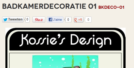

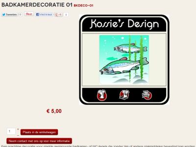

  • Posts: 72
13 years 6 months ago #90428

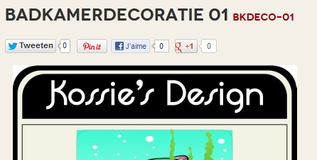

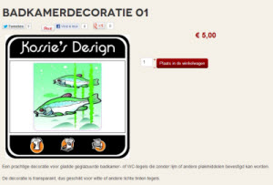

I did apply the css lines to adjust the pinterest button .... it works but leaves two problems ...
1. the Facebook counter is hidden under the G+1 button (see hs05.jpg)
2. the layout of the product detailpage is now corrupted, the image is pushed to the right and the price and amount buttons are pushed below it. (see hs04.jpg)
I tried to move the image part lower with a margin-top added to .hikashop_product_item_left_part but that didnt work.
What css adjustments need i to make for the FB button to show properly, and what adjustment for the page layout to be correct again.
Correct would be:
PRODUCTNAME and PRODUCTCODE (left alligned)
SOCIALBUTTONS (left alligned)
left: IMAGE
right: PRICE and AMOUNT and INFOBUTTON
below all that: PRODUCTDESCRIPTION
Thank you all in advance for any help and wishing everyone a wonderful Sunday!
Last edit: 13 years 6 months ago by Huub.
13 years 6 months ago #90596
You can try ".hikashop_social_google{margin-left: 20px;}" and ".hikashop_product_left_part{margin-top:15px;}" or edit the view "product / show_default" to add a <br/> after the social buttons part.

13 years 6 months ago #90681
Could you give us a link to your website ?
  • Posts: 72
13 years 6 months ago #90682
Send you the info and login info in a PM
Thank you in advance for your help
13 years 6 months ago #90702
The problem for the Facebook and Google buttons seems to be solved.
For the other problem, try this property:
.hikashop_product_left_part{clear: both !important;}
And press Ctrl + F5 to refresh and clear the cache to see the changes.
  • Posts: 72
13 years 6 months ago #90709
Thank you Xavier, that solved the problem with the image and the social plugin.
The problem with the social plugin buttons isnt totally solved however ....for some weird reason the facebook button (the part with the like number) is covered by the Google button.
I also noticed that the order of the buttons totally changes if you change the alignment from left to right and that the Pintrest button is the only one not in a <div>.

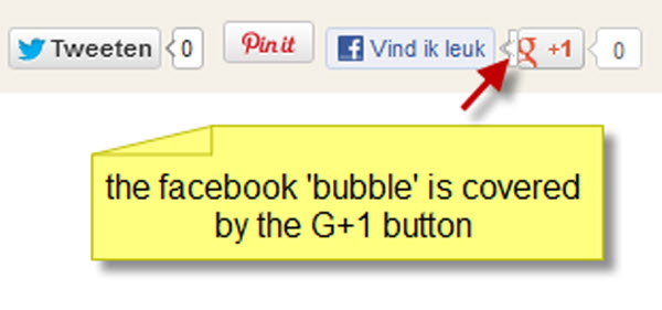

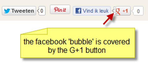

  • Posts: 72
13 years 6 months ago #90827
Hello Xavier,
I made a better picture from the screen so you can see what is wrong.
The 'bubble' from FB that should show the amount of likes is covered by the G+1 button.
(see attached picture)
13 years 6 months ago #90913
Yes, I understand what you mean, but on my end there is no problems, look at the following screenshot:
I tried on Firefox & IE9 && Chrome.
  • Posts: 72
13 years 6 months ago #90914
I see what you mean and understand now the problem ...it is the label on the FB button ...the french text is shorter then the dutch, so it goes well for french but totally wrong for dutch.
