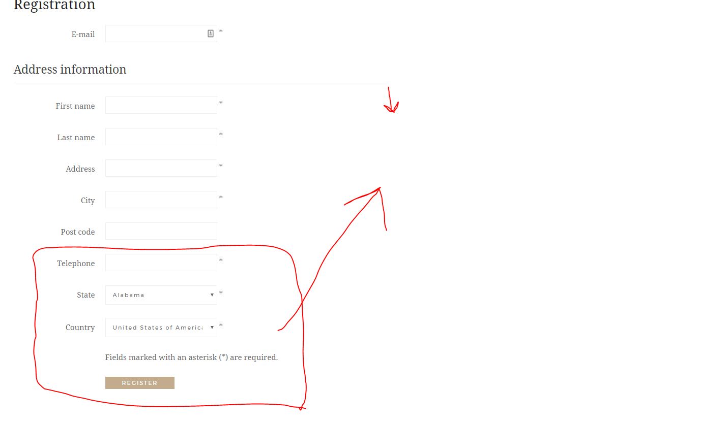

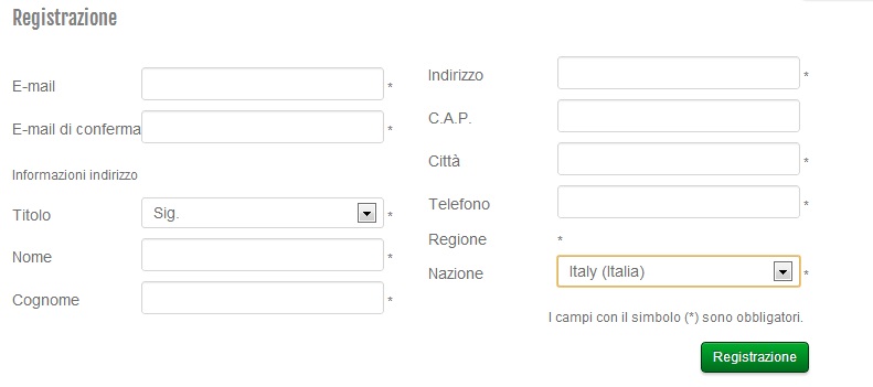

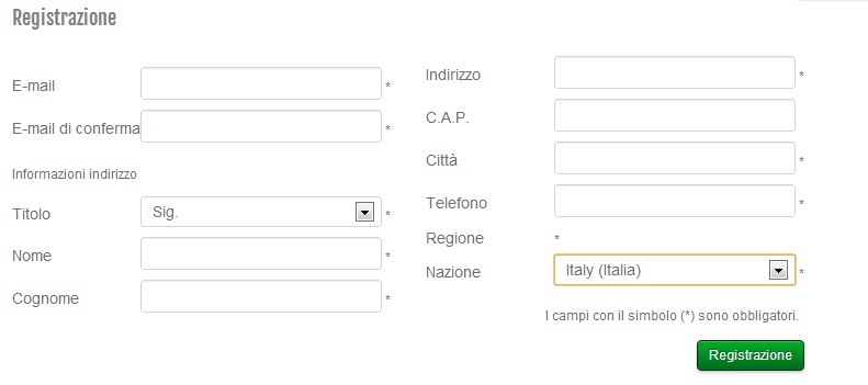

Hello, I would like to change the layout of the registration form.
What I'd like to create is a registration form in 2 column as the picture
Which is the layout concerning the form?
thank you
Last edit: 13 years 6 months ago by davideventurini.
13 years 6 months ago #90884
You have to edit the view "checkout / address".

13 years 6 months ago #91115
Hi there,
It's not especially difficult to do so, you just have to include the different elements for your form in a table (it's an easy html tag).
Or you can put the different part in two div with a css rule like float:left

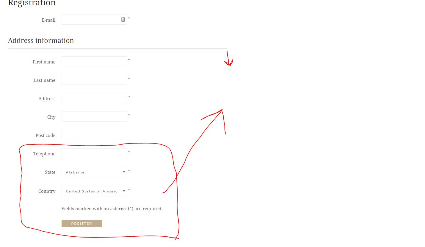

I tried doing the same but can't figure out which part belongs to which field:
I need exactly the same layout and of course to keep it responsive.

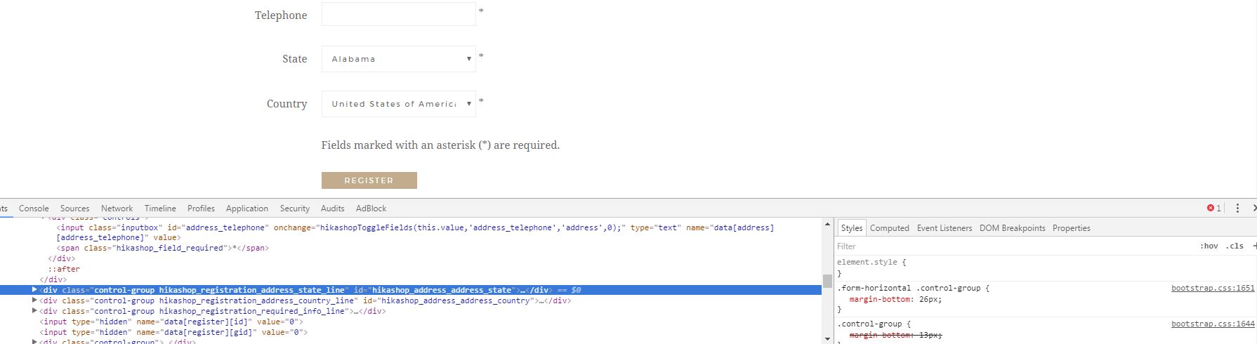

  • Posts: 108
9 years 5 months ago #265470
I have the latest stable version of HikaShop Business: 2.6.4
I cannot find those CSS classes in the checkout page.
I do use bootstrap.
  • Posts: 86102
  • Thank you received: 14203
9 years 5 months ago #265483
I'm not sure what you mean ?
In the screenshot Capture2.JPG you provided in your last message, you did find the classes for the country and for the state.
For example, you could add such CSS:
.hikashop_registration_address .control-group{
width : 49% !important;
float : left !important;
That would make all the address fields on two columns normally.
