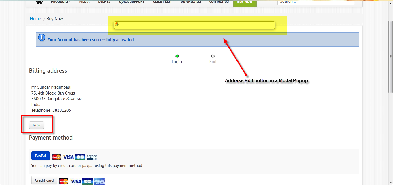

Hi Folks,
I have configured hikashop on a Joomla site that uses a Bootstrap based template. During checkout the button to edit the address shows up in a modal window. How can I change this from modal popup to show up as a button next to the New button. Please see attached below for reference.
Please advice how I can make this change and what files i need to edit?
Best Regards,
Sundar

Hi Sundar,
It's a known issue which come from the template. Some template indeed have a bad handling of joomla 3 bootstrap.
Some solutions have been evocated there:
www.hikashop.com/en/forum/4-how-to/77125...-hover-js.html#84203
It's a css issue so it shouldn't be that hard to solve it :)

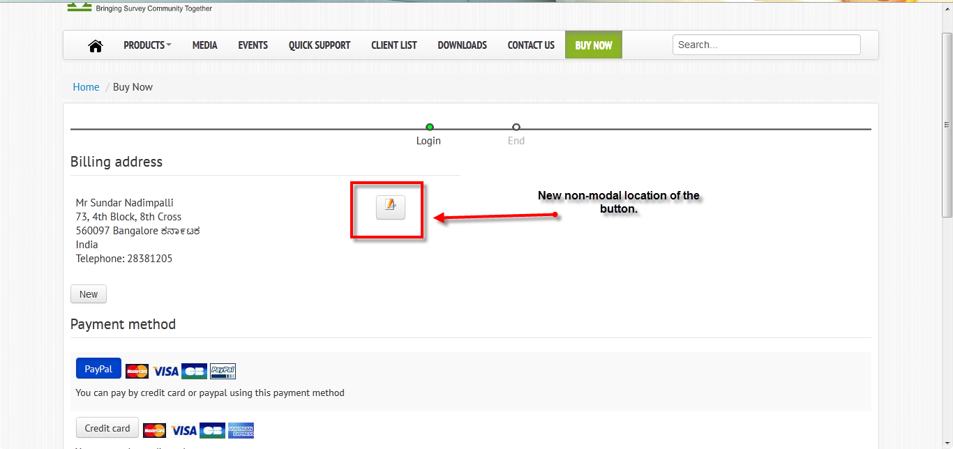

Hi eliot,
Thank you for reply.
I did some digging in the files and found this file: <joomla>\components\com_hikashop\views\checkout\tmpl\address_view.php. This has a modal class applied to an a tag with this ID: id="hikashop_checkout_<?php echo $this->type;?>_address_edit_<?php echo $address->address_id; ?>" and has a class: "modal hikashop_checkout_<?php echo $this->type;?>_address_edit". I copied it to: <templatename>\html\com_hikashop\checkout and have changed it to: "btn hikashop_checkout_<?php echo $this->type;?>_address_edit".
The change is seen in the attached image.
I am ok with this look. Do you think changing this class will affect any the look elsewhere?

13 years 6 months ago #92206
No it affect only this edit button of this view. It the good way of doing that.
