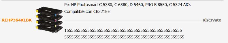

13 years 6 months ago #92870
hi
i try to use this divider in the product description, but it not cuts the description on the listings, you can see in attachment

13 years 6 months ago #92918
Ok, so can you show me how did you set your product description ?
The following user(s) said Thank You: danilo87

13 years 6 months ago #93129
Are you using the view "product / listing_table" ?
Try to edit it and replace:
echo $this->row->product_description;
By:
echo preg_replace('#<hr *id="system-readmore" */>.*#is','',$this->row->product_description);
  • Posts: 47
13 years 6 months ago #93149
perfect now work
