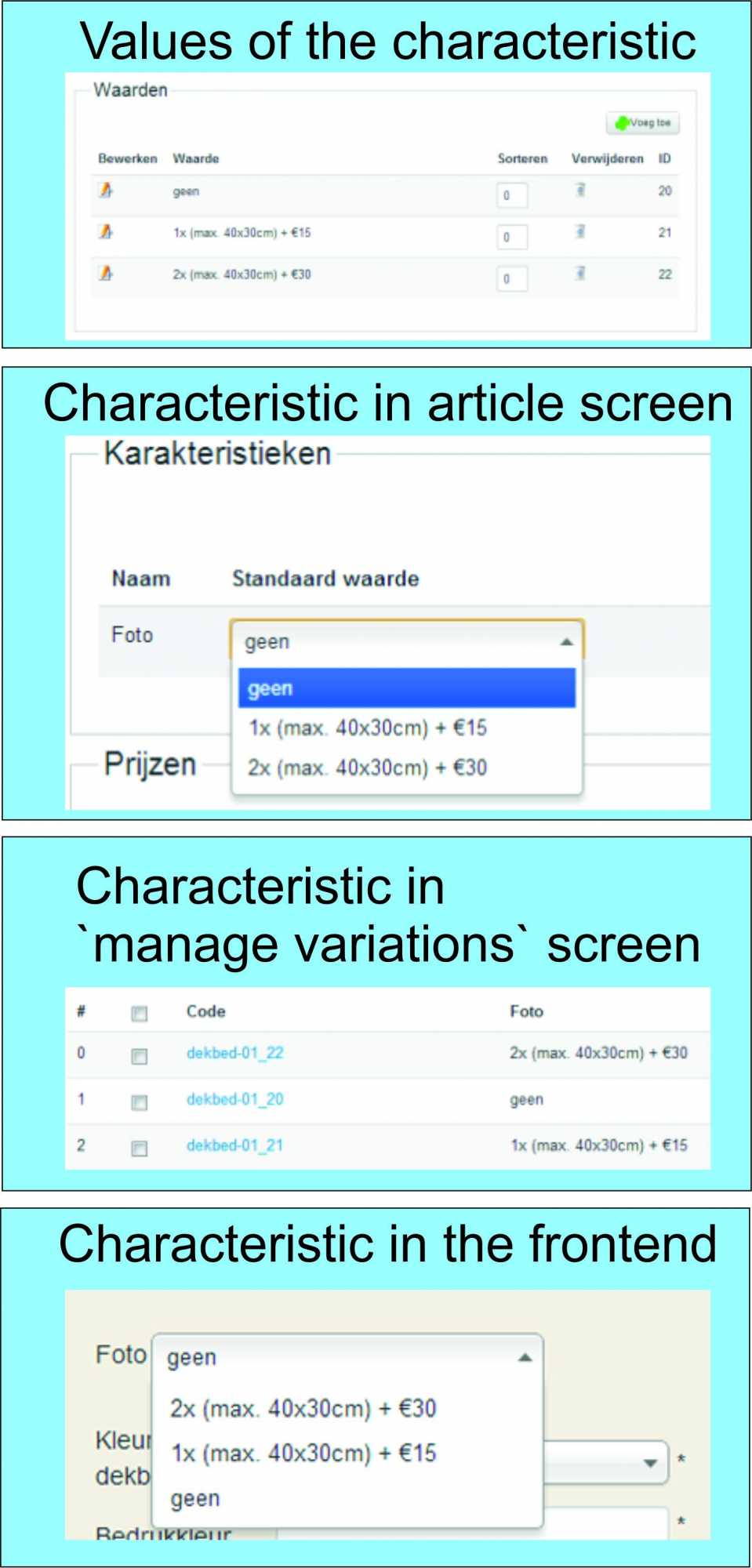

Thank you for your reply but thats not the problem the order of the characteristics is fine there.
The problem occurs in the 'manage variations' screen, there the order of the characteristics is suddenly changed (despite the dropdownlist in the article screen showing the correct order)
I have added a picture that contains the 4 places where the characteristics are shown and you see that the order suddenly changes in the variations screen and in the frontend (both are places where you no longer can change the order).
13 years 6 months ago #92606
Ok, but can you do the things that I told you in my previous post ? then your characteristic order in your manage variants screen should be good.
  • Posts: 72
13 years 6 months ago #92609
Oh now i understand what you were talking about ..... despite they were already in good order there i should give them anyway a order number :)
I did that and it seems to work indeed.
My perception was that it was only needed if you wanted another order for the characteristics then the order in which you had entered them.
Seems you learned me something and helped me solve my little problem ...thank you Mohamed!
