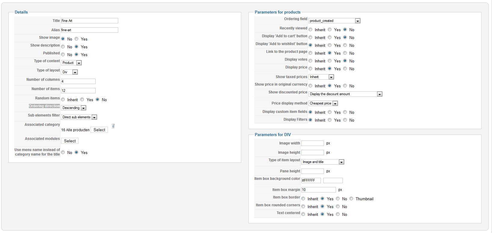

13 years 6 months ago #93563
I think that you'll just have to use the "order" option of your product listing, and set it to product_created.
Hope this will help you.

13 years 6 months ago #93618
Then you should maybe change the value of your Ordering direction option through your product listing's configuration screen.

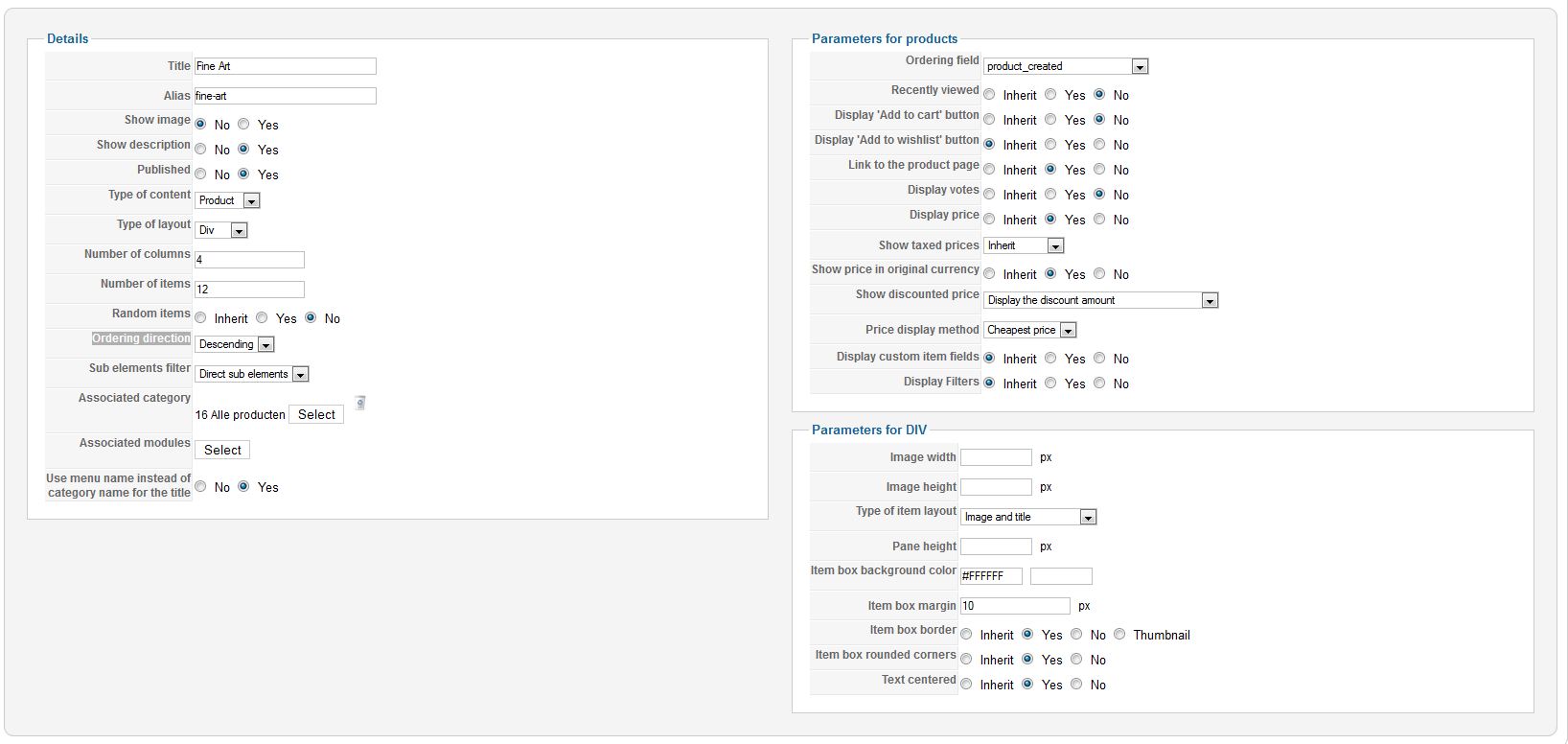

  • Posts: 135
13 years 5 months ago #95503
I have the same problem, but regardless of what I try, playing with "Ordering direction" and "Ordering field", nothing in the order changes. Probably I miss something....
13 years 5 months ago #95577
Are you sure that you are editing the correct menu ?
Your parameters seems to be correct.
  • Posts: 135
13 years 5 months ago #95623
Yes, it worked, for some reason the change was not reflected immediately...
