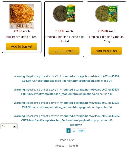

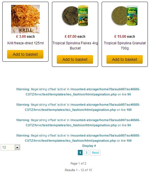

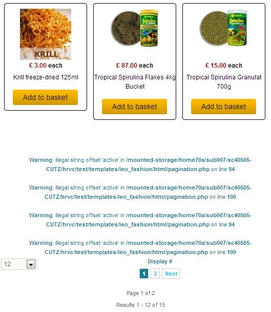

I keep seeing an pagination error message for any category with more than the specified number of products. e.g. I have my settings as:
Type of content > Product
Type of layout > DIV
Number of columns > 3
Number of items > 12
If a category has more than 12 items, I get up to 4 separate pagination errors before the Pagination options at the foot of the page. If I increase the number of items to 24, everything works OK because no category currently has more than 24 items.
The error message (attached) indicates a problem with my templates pagination.php file (also attached).
Can anyone help with this error message?
1 final thing - In the attached capture, there are products with 1 and 2 line names. Is there an easy way to increase the size of the DIV so they are all the same size?

The error is indeed in the template. You should contact your template provider for a proper fix.
As a quick fix, you can either rename that pagination.php file to something else (and that will the user the standard pagination of Joomla instead of the template's pagination), or you can turn off the "error reporting" option of the joomla configuration and that should remove the warning messages.

Genuis! pagination.php renamed and worked as you predicted! Thankyou :)
Now, the other problem I mentioned above, can someone point me in the right direction of the CSS that would need changed to make all 3 boxes in the example the same size. No product name will be longer than 2 lines.

You can force the height of the boxes with CSS like that:
.hikashop_subcontainer{ height : 300px; }
