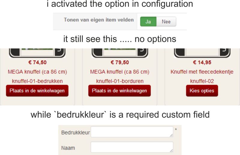

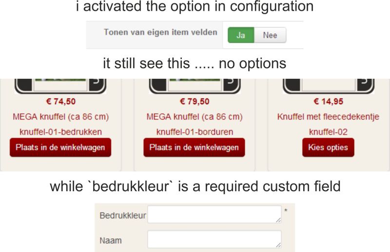

I just took a look at the option you mentioned, i activated "display custom item fields" but nothing changes after that.
I have attached a image that shows the activated option, then shows what i see in the frontend in the product listing and finally shows that i do have a required custom field.

You're probably not turning on that option at the correct place (probably the wrong products listing).
Go in the menu Display->Content modules/menus and edit each products listing menu/module (even the unpublished ones) and turn on that option and that should work.
