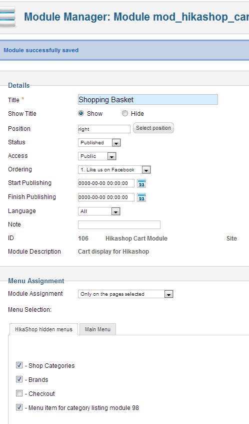

You should be able to change on what page the Cart and Menu show via the Joomla Module Manager. Select the Shopping Basket Module and change the Menu Assignment at the bottom of the page from All Pages, to only on the select pages. Change the Menu Selection to HikaShop hidden menus and deselect Checkout. Repeat this for your menu module.
I just tested it on mine, and the Cart module did not show when I moved through to checkout.

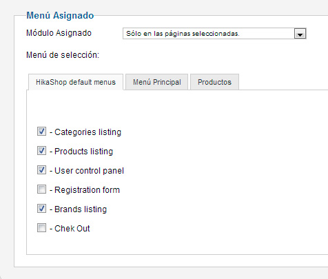

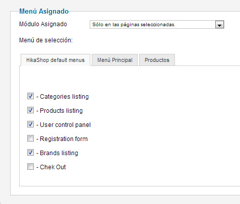

thanks for your reply but in my case I do not see the option to own modules, I get the following:
I've configured based on your instructions and still appear the modules.
Not if there's a configuration problem.Thank you very much in advance for your help.
