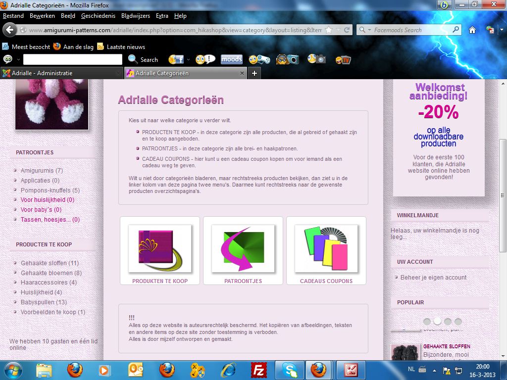

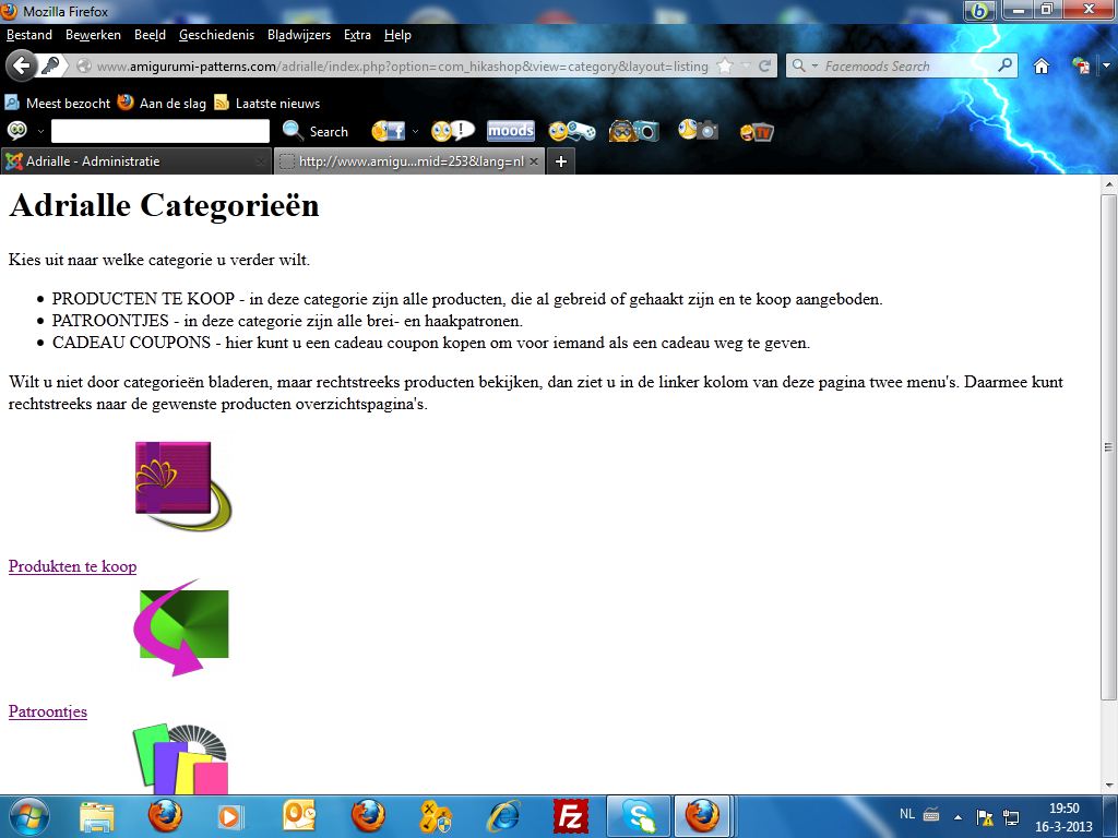

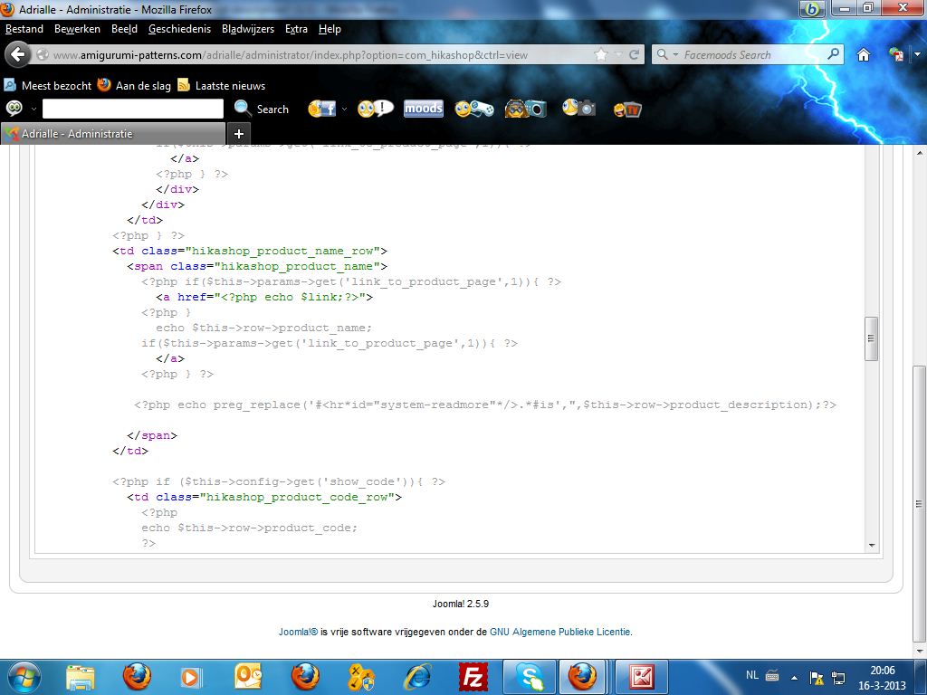

  • Posts: 222
13 years 5 months ago #94836
That same.
On the first image my corect website, on the second image, what happened if I add this code, and on the third image where I added code

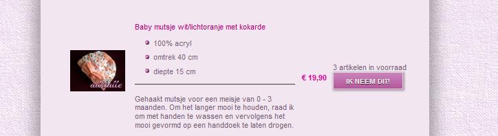

  • Posts: 222
13 years 5 months ago #95030
Now I have this finally, but the whole description. So, not just a short, but a short description + black line + a long description...
Who can I have just a short description in product listing? A short description has to be not a link. Links are image and the name of product. Because my link is of pink color, than is enough just the name us a link. A short description I wil in normal grey color. Others the all text pink is not nice and too much pink color.
Can you help me?
Vero
Vero

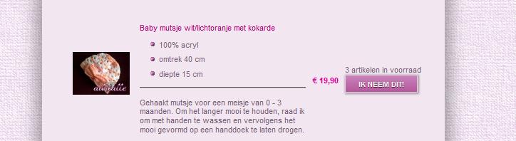

  • Posts: 222
13 years 5 months ago #95124
nicolas wrote: The code proposed by Xavier will display the short description.
If you want the full description, then simply use that code instead:
<?php echo $this->row->product_description; ?>
I know that my Englisch is not good, I try again.
I wil only! short description on product listig table pages. With the code proposed by Xavier I have a short description + black line + a long description on those pages. So I have all! on those pages, but I wil only! a short description that is above the readmore link.
That is the image what I have now:
you see the black line and under this line the whole description is shown. I need only the first three lines of text and don't need this black line and the rest of the text under that line.

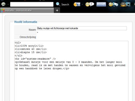

  • Posts: 86112
  • Thank you received: 14210
13 years 5 months ago #95171
Then it means that the description of the product doesn't have a valid read more tag.
Please make sure that it uses:
<hr id="system-readmore" />
  • Posts: 222
13 years 5 months ago #95228
nicolas wrote: Then it means that the description of the product doesn't have a valid read more tag.
It uses, of course. Do you see that black line? If it not uses, will be no line. I made sure.

  • Posts: 2334
  • Thank you received: 403
13 years 5 months ago #95268
Hi there,
Here the right line, sorry about the first mistakes:
<?php echo preg_replace('#<hr *id="system-readmore" */>.*#is','',$this->row->product_description); ?>
