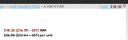

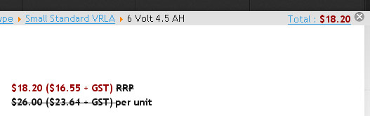

Ok, that gets me to here
but what do I need to move to swap them around
  • Posts: 86179
  • Thank you received: 14214
15 years 7 months ago #7941
Ah yes, if you want to swap them, you're have to edit the view file. You can just move the whole block of code of the if(!empty($this->row->discount)) before the line echo '<span class="'.$class.'">';
Then, instead of using PRICE_DISCOUNT_START="RRP<br/>", you'll want to use PRICE_DISCOUNT_END="RRP<br/>"
  • Posts: 78
15 years 7 months ago #7942
Thats got it, had to drop the per_unit text but thats not a problem. Thanks again Nicolas
