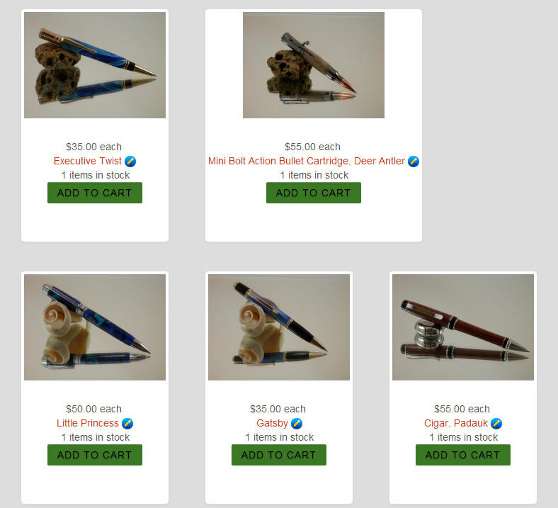

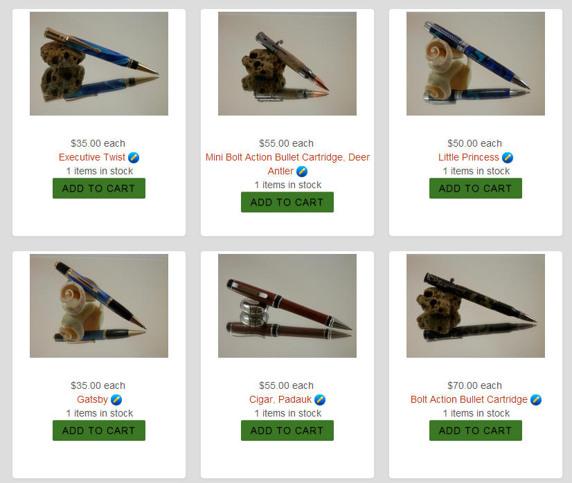

hi again. I had to change the back end general display to use bootstrap design in order to accommodate the way the products show up on tablets - portrait view (the were not wrapping correctly). Once i did this it corrected that issue however now on my main view the code that i put in to wrap the text is not working correctly. I have two attachments, one the way it looks without bootstrap enabled and then one with. The code i am using that did work is:
.hikashop_products_listing .hikashop_subcontainer {
min-height: 320px;
  • Posts: 85163
  • Thank you received: 13894
12 years 3 months ago #130704
I don't see that problem on your page vaporandco.com/categorylistings/category/20-tips-and-cartridges
Are you talking about another website ? Can you give a link to the page of your screenshot ?
  • Posts: 102
12 years 3 months ago #130717
12 years 3 months ago #130809
It seems that you are using the list display type, thanks to try with the div one in the menu/module parameters.
You template is overriding our css properties, we set a width in percentage for this kind of listings, but on your page, it's missing.
