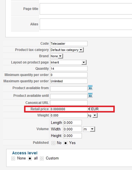

13 years 5 months ago #96122
It's around the dimension informations. Here is a screenshot ;):
Attachment not found

13 years 5 months ago #96149
Is that a "new" feature (being within the last 4-5 months)
