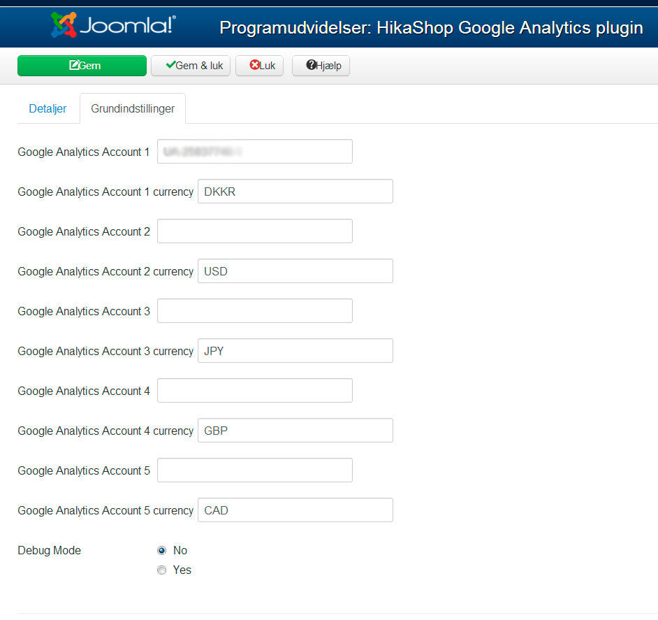

Can you do a screenshot of the options screen of the plugin (with the private information blurred) ?
  • Posts: 41
13 years 5 months ago #96252
I know, The plugins waspublished before all my orders and none of them are figuring in analytic.
I have attached a printscreen.
  • Posts: 86112
  • Thank you received: 14210
13 years 5 months ago #96597
Your currency is not valid. DKKR does not exist.
It can only have three letters. Here is a list of all the valid currency codes:
www.xe.com/iso4217.php
The following user(s) said Thank You: Razavi
  • Posts: 41
13 years 5 months ago #96607
That explains a lot, thank you for assitance.
