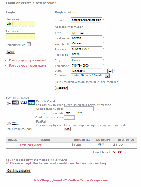

I'm having trouble getting it set right. After hitting "register", it doesn't do anything, and there isn't a "make payment' or whatever button below the payment options.
What am I doing wrong?

s446956729.onlinehome.us/index.php/jewelry-accessories
As of right now, if you click "register" it simply refreshed the page with no indication of the address being saved anywhere.
And below the payment options, there's no "next" button or any indication that the payment information is being saved or moved onto to the next stage.

13 years 5 months ago #96699
I am apparently not seeing the same thing you are.
Attached is what I see. I enter my address information in the "Registration" area top right and then click "Register". This only refreshes the page but doesn't seem to save, or keep that information anywhere.
Once the page is refreshed I still see no "Next" button to continue after entering in payment information, specifically the "Credit Card" option.
13 years 5 months ago #96736
It's actually working for me :
- Did you solved your problem ?
- Did you press the login button instead of the register button ?

13 years 5 months ago #97350
If you enable the login and set registration to "simplified" so the customer can login OR enter his address to checkout.
  • Posts: 51
13 years 5 months ago #97447
Ok, I switched it to simplified.
When I click "Register" it still just refreshed the page with no indication that the address was saved, and therefor, doesn't not allow me to continue to move on with paying for the cart.
13 years 5 months ago #97556
I still don't see the Joomla error/notice message. Are you sure that they are working ?
Because all the informations given to the customer are in these messages.
You have maybe a css property which hide them, or something else.
And in the Joomla options I think that you have set that the customers needs to validate their account via a link sent in an email.
You can change this option to allow registration without confirmation.
