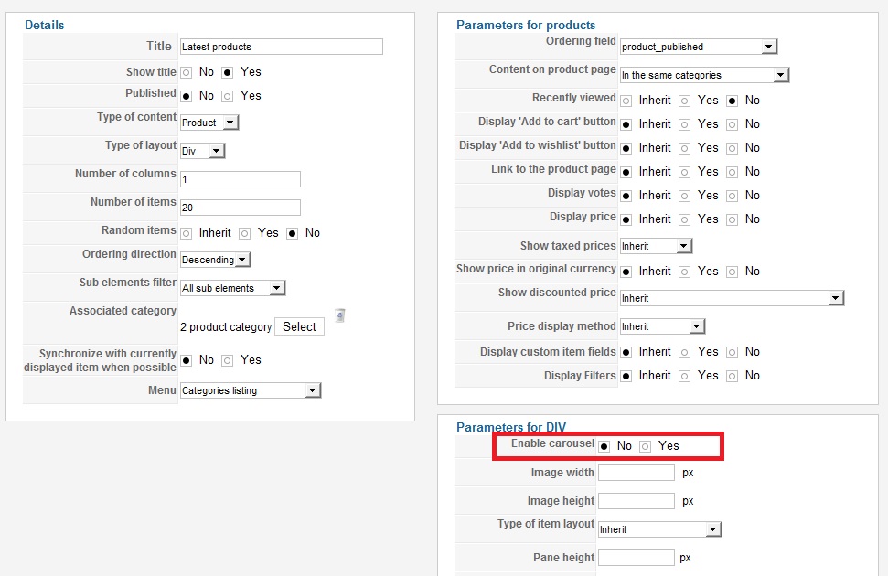

Hi Xavier,
in configuration > display > Modules main default options
I find "TYPE OF LAYOUT" and it is set to div
but where can i find "enable carousel"?
On the right side of what?
If you mean the right side of the page "Display" i don't have the "enable carousel"
my site with Hikashop
www.lacasettabio.it
  • Posts: 2334
  • Thank you received: 403
13 years 5 months ago #96349
There it is, in the module or menu edition page:
Attachment not found
The following user(s) said Thank You: lacasetta

  • Posts: 86112
  • Thank you received: 14210
13 years 5 months ago #96908
I suppose that the module is still displayed but that the "Synchronize with currently displayed item when possible" option of the carousel module is turned on and so it always tries to display the subcategories of the current category and when you're on a product listing with no subcategories, it just displays nothing.
You should turn off that option in your module since you always want the same categories displayed in the module.
