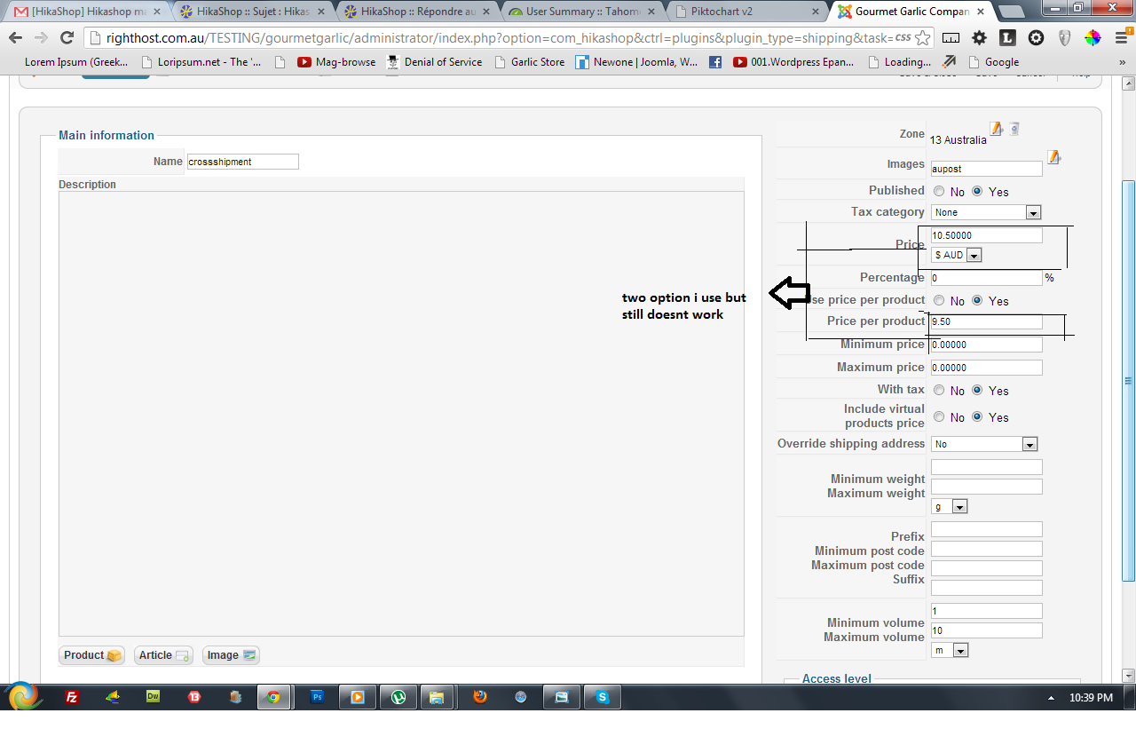

Ill explain all the flows of the store because i made some restriction on shipments.
There are two shipping options to be used the first one is more per product shipments that apply in this category
Garlic – to eat or plant. It has restriction every 500 grams of garlic you cart the shipment fee $9.50 and if you cart every 1 kilogram of garlic the shipping fee 12.00
The Second Option is allowing fix shipment fee that apply this categories Garlic Purees,Garlic Condiments,Garlic Infused Oils,Garlic Accessories.but it has restriction every 1-3 products you cart the shipping fee is $10.50 and if you cart greater than 3 products the shipping fee is $17.50
Main problem sir that when i cart 1 product from Garlic – to eat or plant and also 1 product from Garlic Purees.it should sum the two products but it doesnt function. and it has conflicts with other shipment restrictions on it.i attached pdf file
Hoping you get this problem
Looking Forward

13 years 5 months ago #96826
Ok,
Regarding the fixed shipping rate, my solution would be to set all your product's weight to 1g and then create :
- 1 shipping method with the "minimum/maximum weight" options set to 0-3
- 1 shipping method with the "minimum weight" options set to 3
Regarding your "garlic" shipping rate, my solution would be to :
- Set all your product's weight to 1Kg
- Create a shipping method with the "Price" option set to $9.50 and use the "price per product" option
However you can't for the moment directly restrict a shipping method to a product's category so if you create these shipping methods, both will or just the second will show with and extra shipping rate, because of the "price per product" option.
  • Posts: 11
