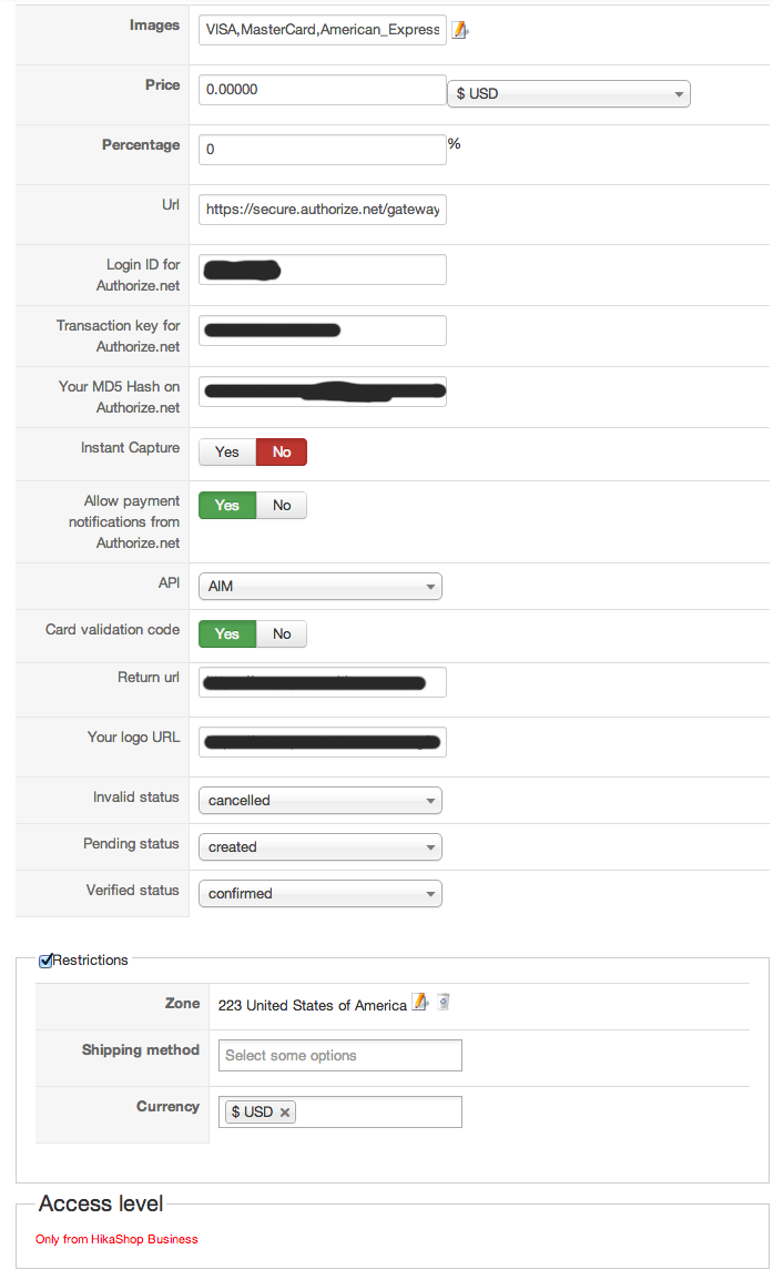

I am using authorize.net plugin for payments. I've attached a screen capture with settings.
I chose AIM method, so that credit card info is typed on joomla page.

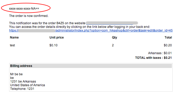

when i add that code, i get that email (attached)
thanks

13 years 5 months ago #97221
I forgot a piece:
xxxx-xxxx-xxxx-<?php $app = JFactory::getApplication();
echo substr(base64_decode($app->getUserState( HIKASHOP_COMPONENT.'.cc_number')),-4); ?>

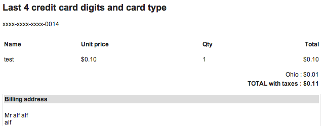

13 years 5 months ago #97445
Thanks for your help, but it doesn't work.
But i type:
<tr>
<h2>Last 4 credit card digits and card type</h2>
<div>xxxx-xxxx-xxxx-<?php $app = JFactory::getApplication();
echo substr(base64_decode($app->getUserState( HIKASHOP_COMPONENT.'.cc_number')),-4); ?></div>
<br>
<div><?php $app = JFactory::getApplication();
echo base64_decode($app->getUserState( HIKASHOP_COMPONENT.'.cc_type')); ?></div>
</tr>
and i get that email:

13 years 5 months ago #97582
Mmm. I checked on the Authorize.net documentation but the cart type is actually not given back so we don't know it and thus it's not possible to display it in that email.
