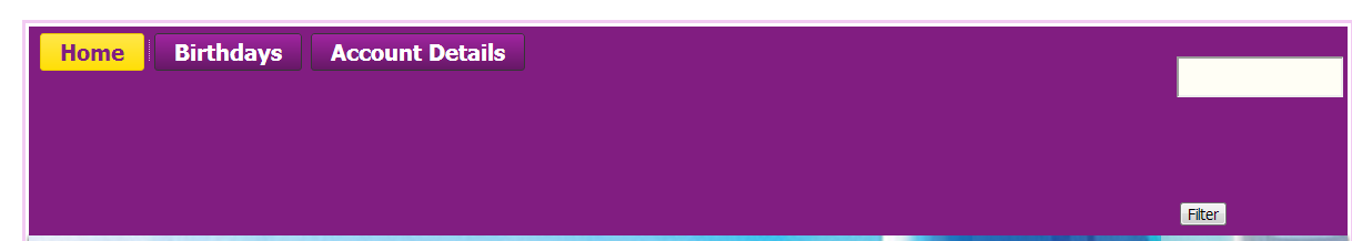

I have been searching this forum and find most of the answers I have needed so far. But there is one question I just cant work out, more to do with my lack of CSS skills.
I would like to steam line the filter search box to fit into the menu bar at the top and macht the size of the buttons in the menu bar. Can anyone help me?

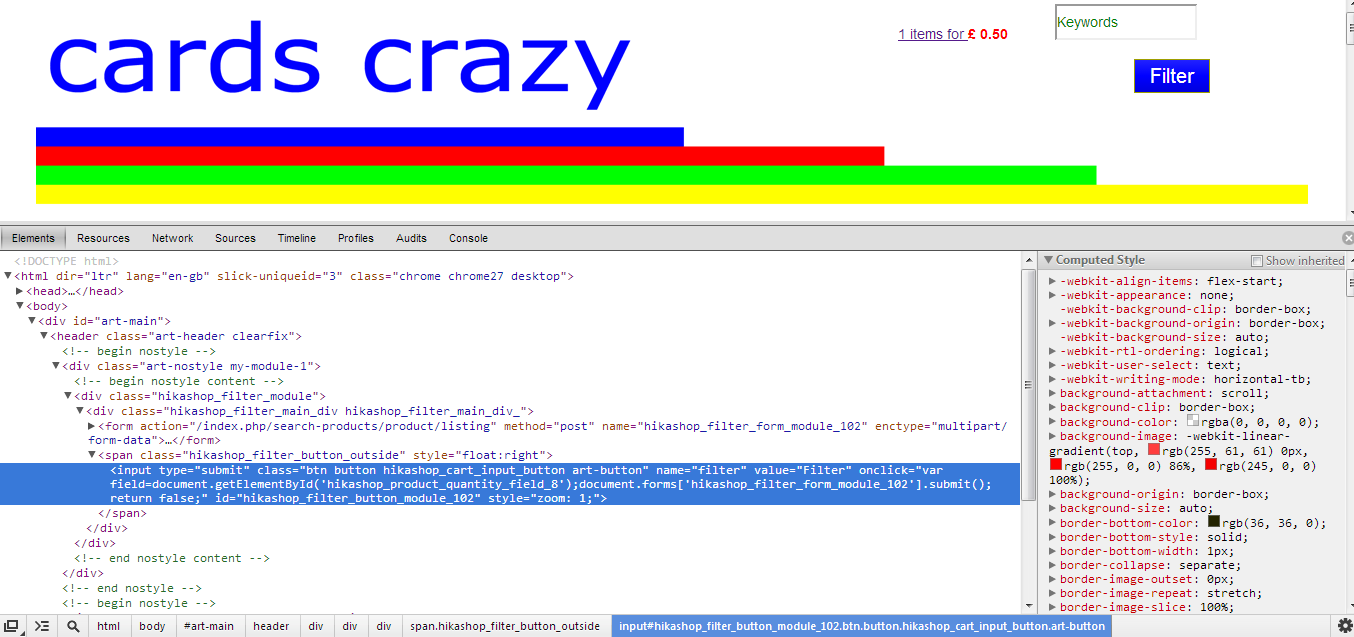

13 years 2 months ago #109229
I have found the class or id but don't where I cant edit it. See below.

13 years 2 months ago #109253
You have to add your css to the front end css file in System>Configuration>Display>CSS
For example with your id:
#hikashop_filter_button_module_102{
 //whateveryouwant;
