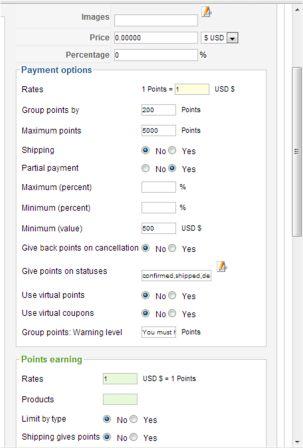

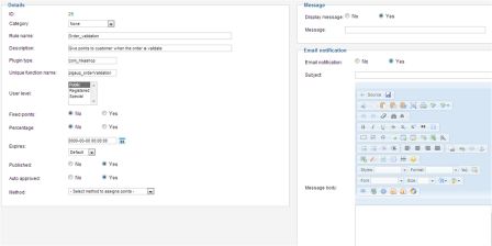

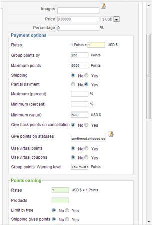

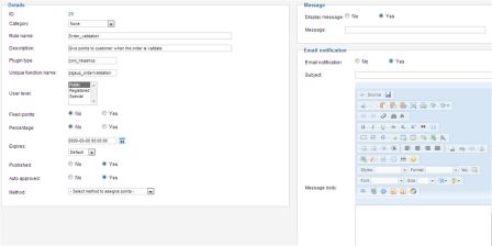

Alpha User Points as a payment method is not showing up during check-out. The plug-in is enabled. I have set up the Payment Method per the documentation and "enabled" the Order_Validation rule (see attached). Can you give me some ideas on why it isn't showing up?
I would also like to customize the email that users receive when they have received points for their order. Can you tell me how I would code the email so that it will retrieve the users current points and the amount of points they received for their order?

The value of "Group points: Warning level" should be a number.
Let it empty if you don't want to have a warning.
Your group points is "200", it means that the customer should have more than 200 points and the order should be higher than 200$
If these rules are not respected, the payment method would not be listed in the front end.
