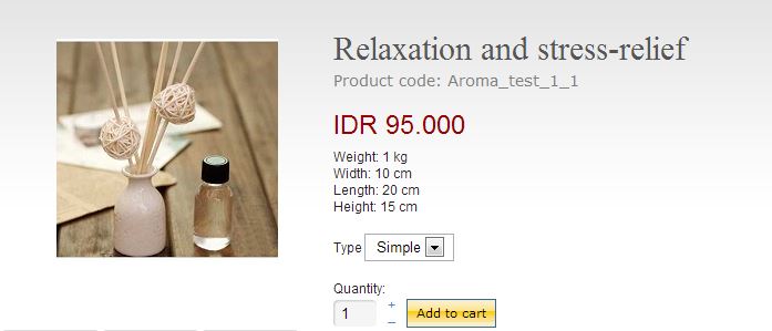

I would like to add text before the quantity box. Please see the pictures attached to see what i mean.
Many thanks in advance!
Max

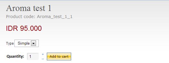

Thanks for the quick reply. How can I make it bold and put it at the same line as the quantity box? Because now it is located on the top of the quantity box. Please see the picture attached.

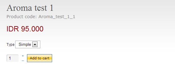

  • Posts: 12
13 years 5 months ago #98148
I also found that if I add the text quantity in the location you suggested, it appears everywhere before add to cart button; not only in product page but everything that has "Add to cart" button, such as product listing and related products.

13 years 5 months ago #98471
Are you talking about:
If you want to move it on the same line of the input field, you can probably do that via css, or you will have to add divs to display the content one next to the other one.[/code]
If it is, you can use something like:
<div class="hikashop_product_stock" style="width: 305px;">
	<div style="width: 50px; float:left;">
		<b>Quantity:</b>
	</div>
	<div style="width: 250px; float:left;">
                // the add to cart part
        </div>
</div>

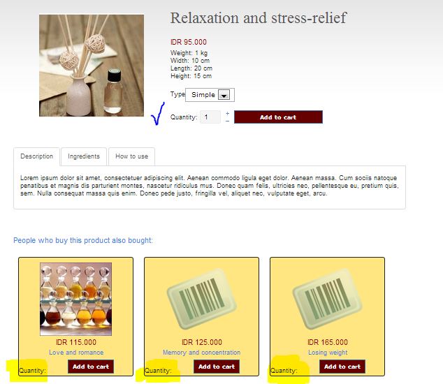

I hope you would be kind enough to answer one more question of mine regarding quantity text. Currently, the quantity text in the product page appear both in the main product and in the related product section (please see my attachment). I would like to show it only in the main product, and not in the related products (the yellow one).
Would this be possible? If you can give me even just the general information on how to do it, that would be fantastic.
Many thanks in advance Xavier.
13 years 4 months ago #98767
I think that you can add an if condition aroud the quantity text like:
if($module_id == 0){
    // Display quantity text.
The following user(s) said Thank You: max.mandias
