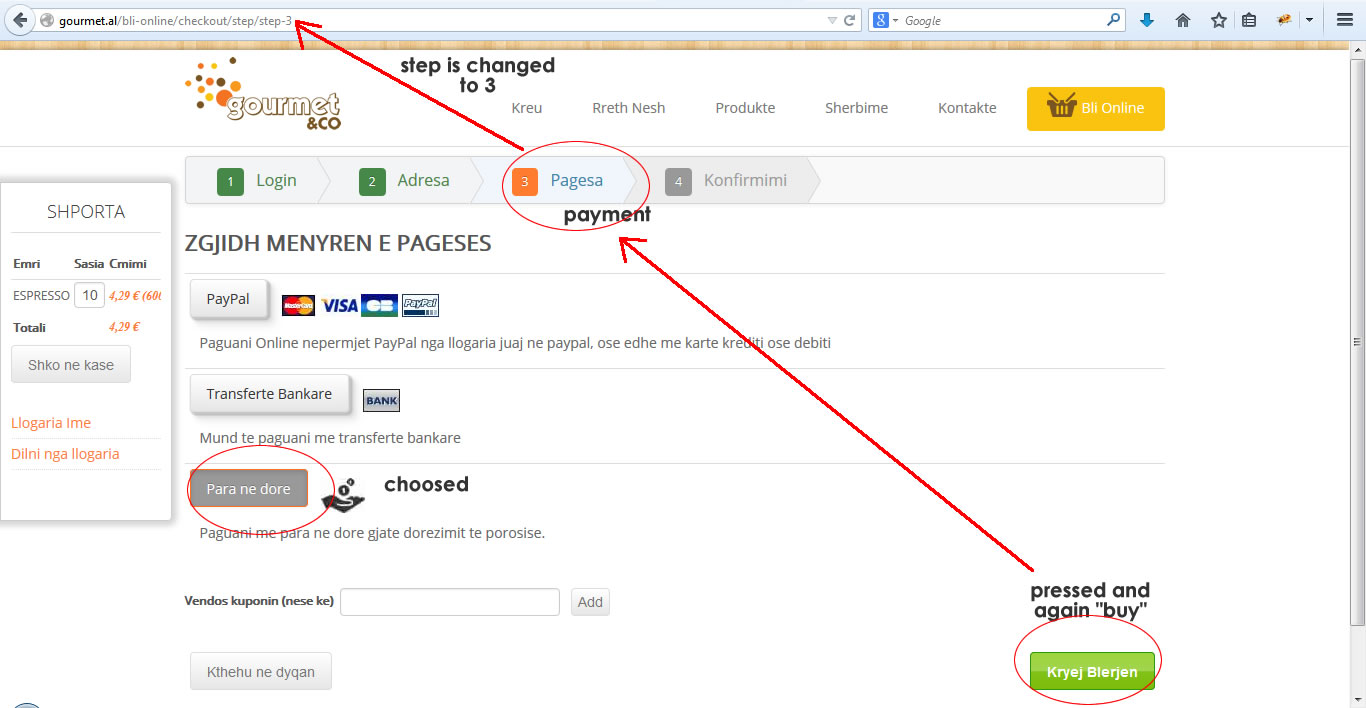

hi,
i am experiencing same situation. i need to click twict to complete the order in the last step. you can test it here: gourmet.al/bli-online
it is a serious issue when it comes to user experience and conversions...

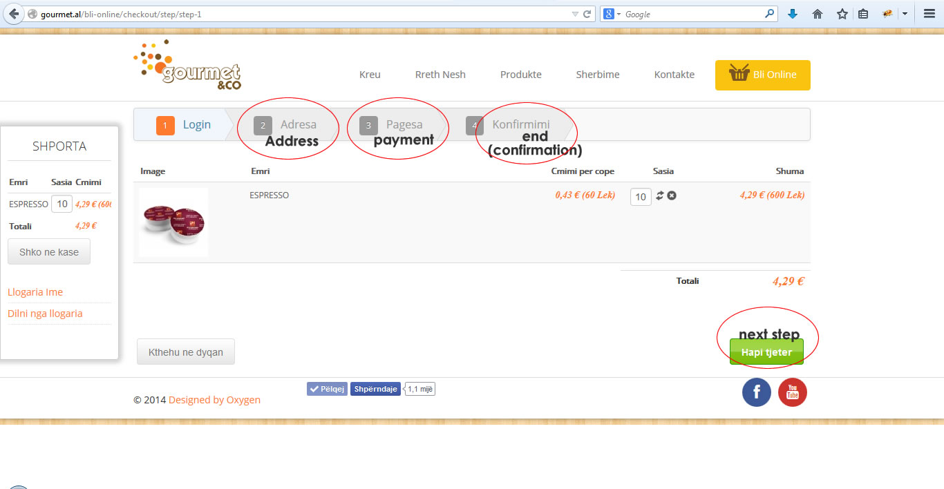

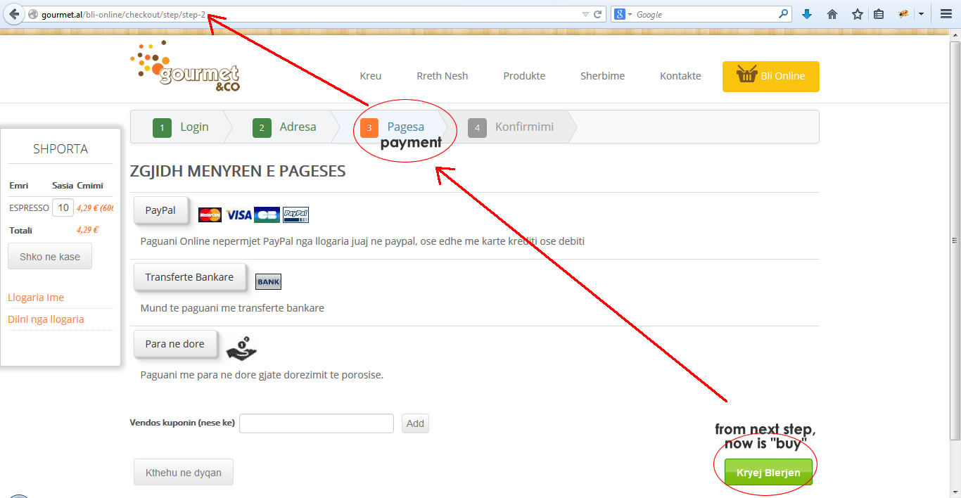

11 years 9 months ago #178945
in the pages 02.jpg and 03.jpg you see same screen asking same thing, but in the url is changed the step number...
i choose payment method, than click buy. in this step, after page reload, i need to press again buy.
Versions:
You have the latest stable version of HikaShop Starter: 2.3.4
Joomla! 3.3.6 Stable
Last edit: 11 years 9 months ago by frama.
11 years 9 months ago #179036
The displayed URL is the step you should display but because the checkout is "redirecting" you in the same step as previously, you see "step-3" instead of "step-2" (yes the first step is "step-0".. We will work on that for the checkout re-factoring).
Because your payment method is not pre-selected and you do not use the option "Auto submit shipping and payment methods selection", you have to select first the payment method and you need to confirm it.
The selection of the payment method can influence the cart or the shipping ; that's why HikaShop have to display some kind of confirmation step.
By using the option "Auto submit shipping and payment methods selection", you will avoid that.
