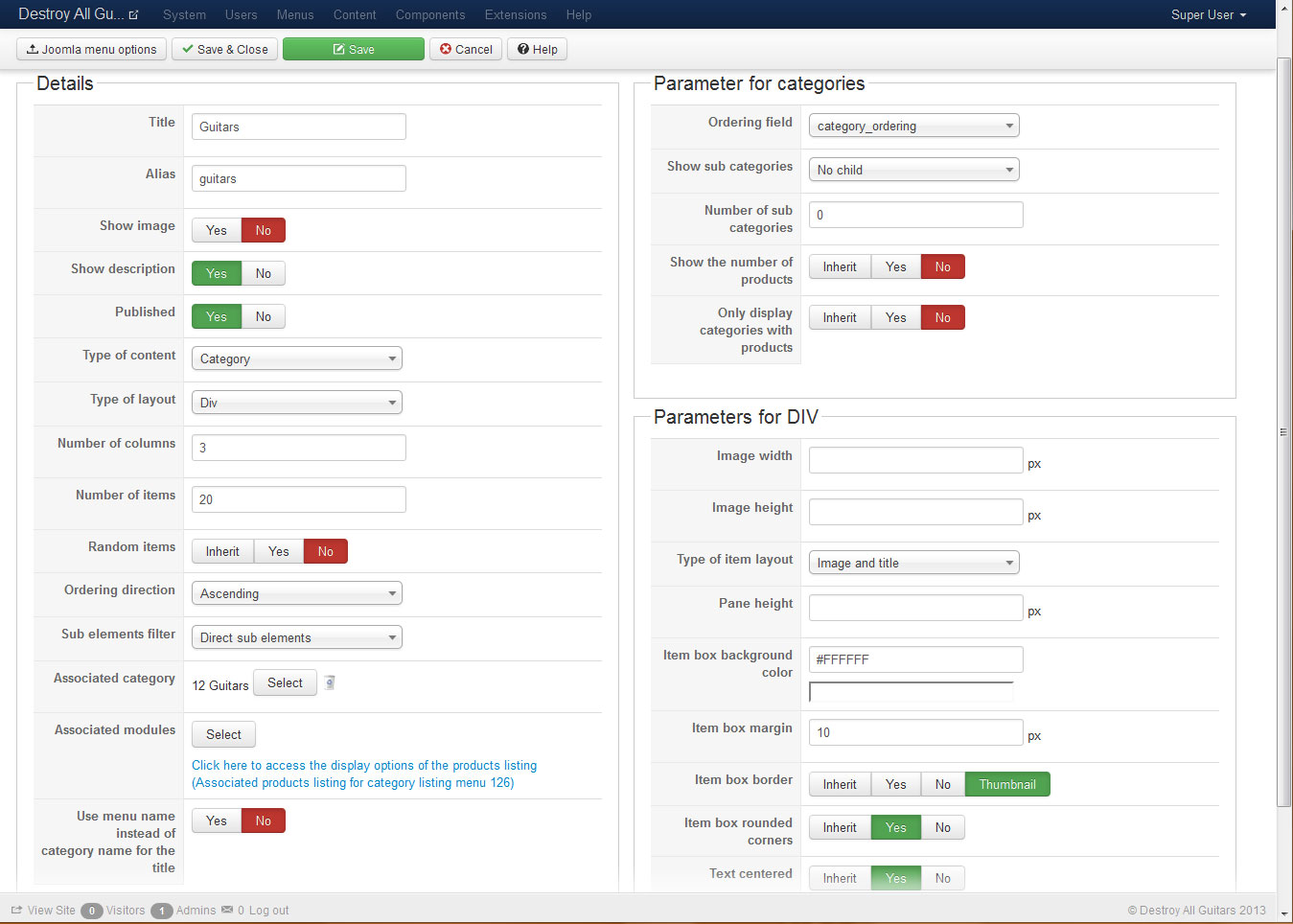

Here is an example page from the site in development where this is happening: www.destroyallguitars.net/index.php/guitars/14-artinger
The page is reached by clicking the menu item (Guitars), then clicking the one category that is there (Artinger). The resulting page shows the category description and displays sub categories underneath - I do not want the sub categories "Artinger new arrivals" or "Artinger sales archive" to be showing because I want to create my own links to those areas separately.
I have attached a screenshot of the menu settings page for the Guitars menu item (HikaShop-->Display-->Content menus-->Guitars (the menu item I am trying to edit). You can see that I have selected "No child" under "Show sub categories."
Thank you for your help.
  • Posts: 86112
  • Thank you received: 14209
13 years 4 months ago #99212
So we're not talking about the same thing.
These options are to not display the sub categories list in each category box listed on the page. And as expected, you don't have a the listings of the sub categories in each category box on that listing: www.destroyallguitars.net/index.php/guitars
So it's actually doing what is should.
What you want to do though is not possible via the options provide with the categories structure that you have.
