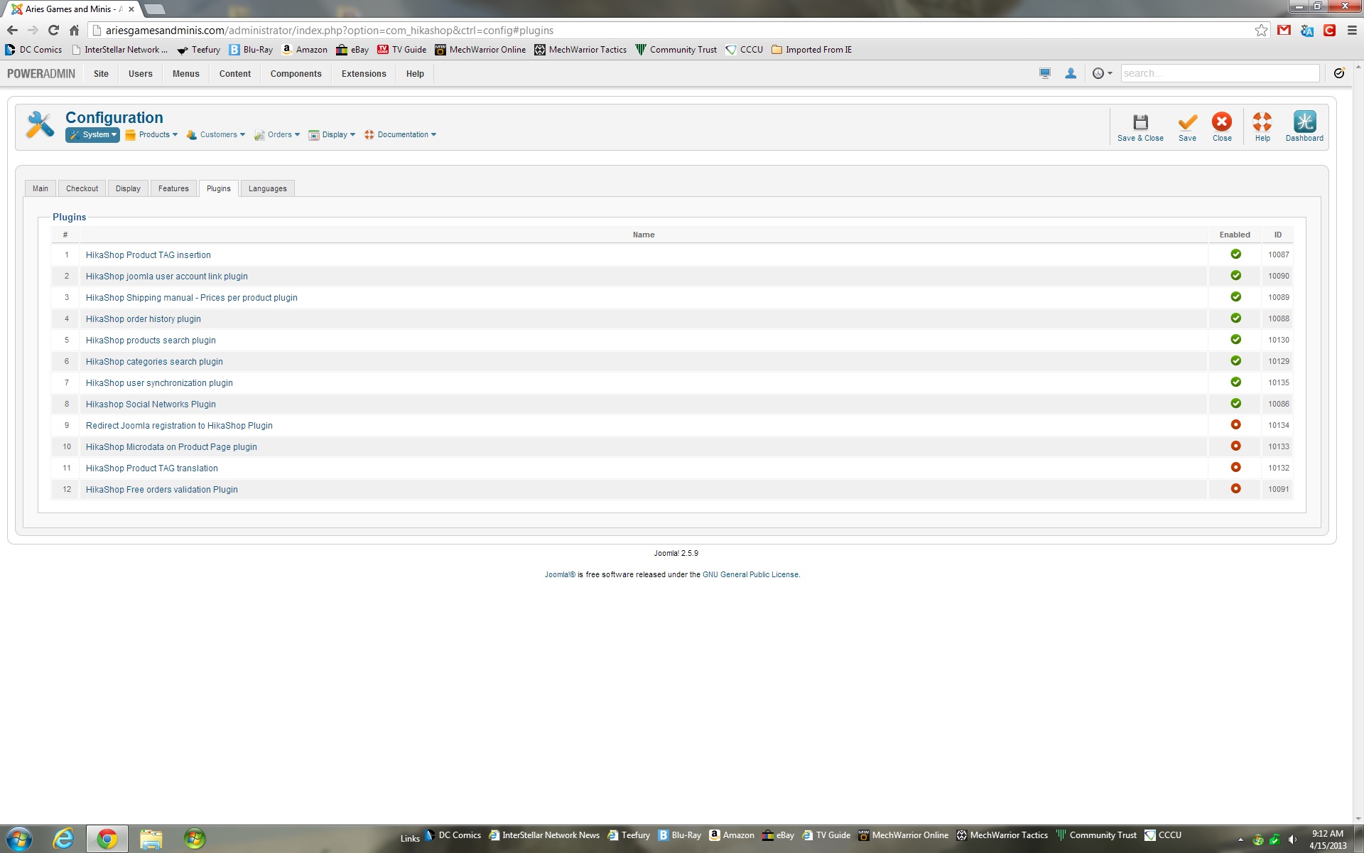

13 years 4 months ago #99187
Ok, I think I found the plugins for Hikashop (screen shot attached)...but I don't see any search plugin listed. Am I looking in the wrong place?
  • Posts: 86112
  • Thank you received: 14209
13 years 4 months ago #99209
You're at the correct place and I can see the search plugins on your screenshot... Please read carefully... lines 5 and 6 of the listing.

13 years 4 months ago #102571
Nicolas...any other advice on this? Both of the following are enabled, and I still don't have any search box on my shopping site...
#5 HikaShop products search plugin
#6 HikaShop categories search plugin

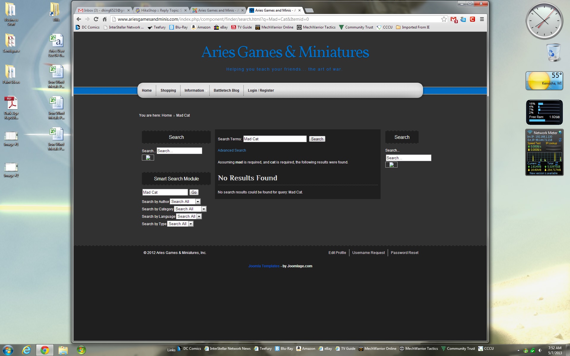

The search box is up, but it is not returning any results. The module that I found in Joomla is "Smart Search Module". Is this the correct one?
I want it to search products on my site...so maybe I don't have one of the search modules set correctly? I'm going to toy with it further to see if I can figure it out...but any tips would be appreciated.

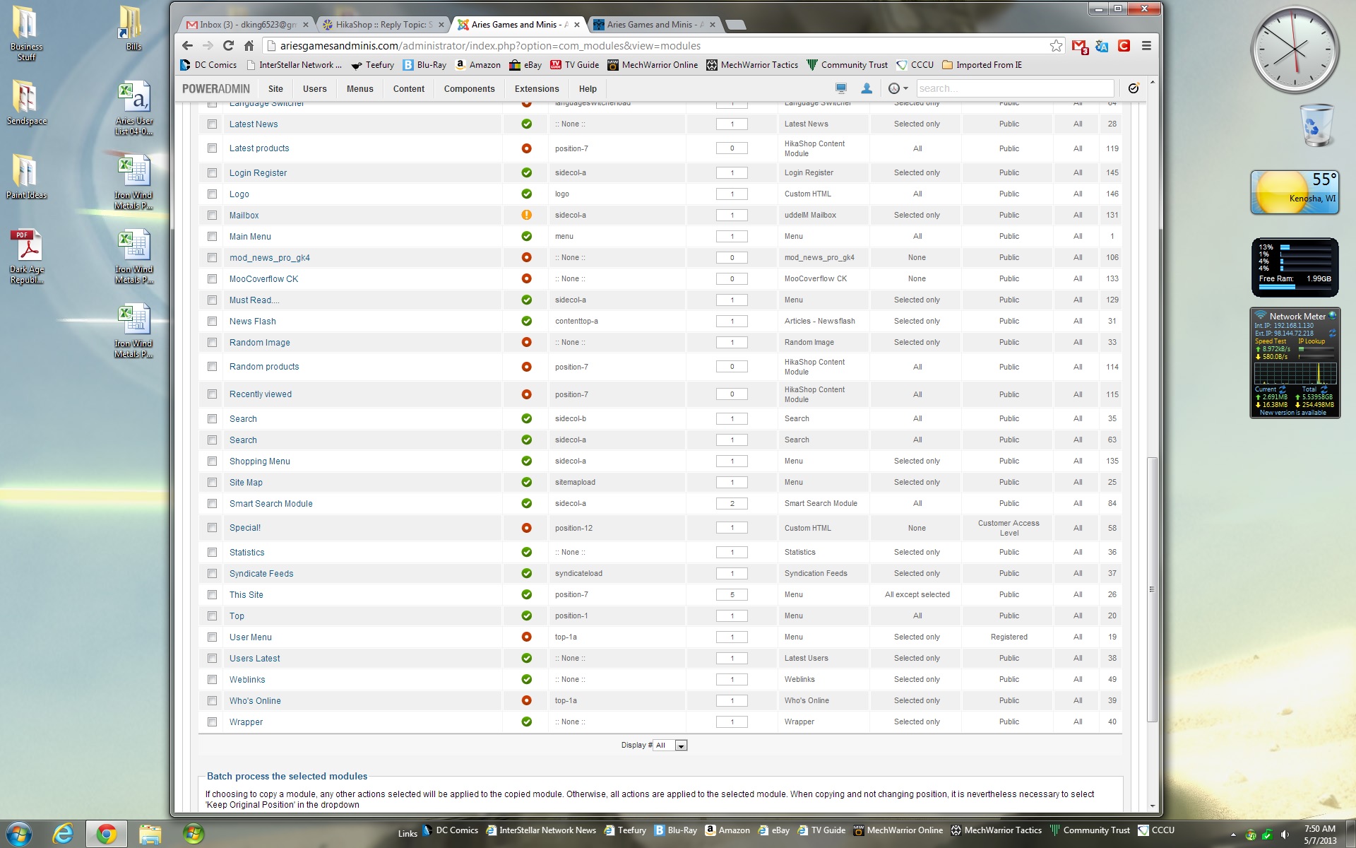

13 years 4 months ago #102658
Ok...a little bit of toying found 2 other search modules...but when enabled, and I type something in them to search, they error out.
Image #1 is of the modules I found
Image #2 is of the error I get when I use either of the modules titled "Search"
Image #3 is of the screen I get when searching for something I KNOW I have listed.
I tried the 2 "Search" modules for Image #2 and they both did the same thing. Which one is the correct one, and what should I do here? Once I have it all set, I will only have one search bar...I just enabled the 3 at so I can compare what they would so I could post here.
13 years 4 months ago #102660
You have to use the Joomla search module which is generally named "Search" and not "Smart search".
Smart search is maybe a module installed with another component.
Try to use the default Joomla search module, it can be added by creating a new module.

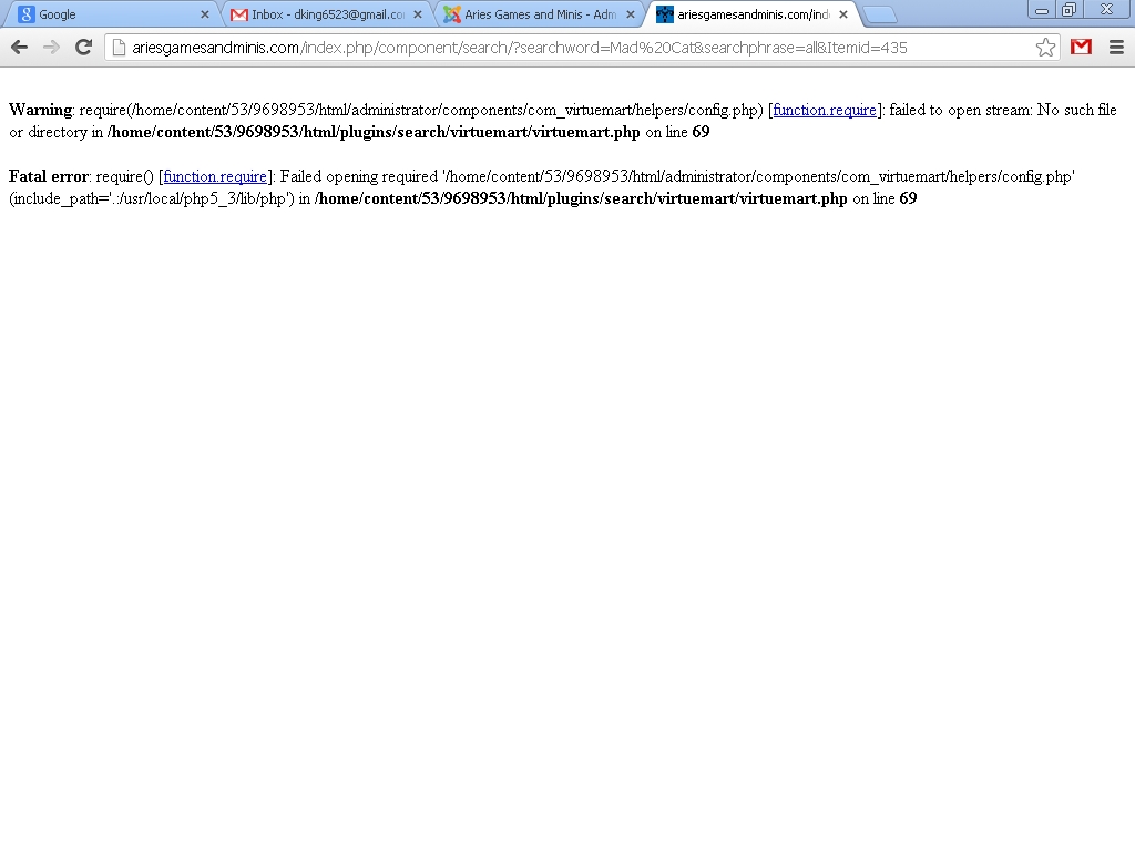

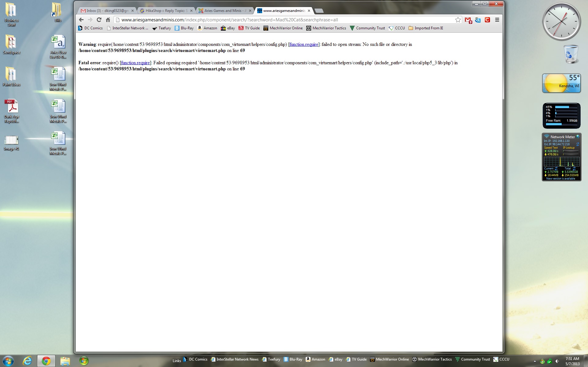

13 years 4 months ago #102716
Ok...I deleted the Smart Search module and confirmed it wasn't tied to anything else.
I deleted the other two modules listed as "Search" and I made a new Search Module as you stated.
Still getting the error attached. Any thoughts? Thanks
  • Posts: 26384
  • Thank you received: 4077
13 years 4 months ago #102718
You have an error with the "virtuemart search plugin". Please unpublish it.
