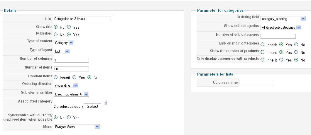

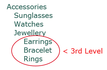

I see another level when I change the setting but it does not flow with how I have it set-up. It's hard to explain but I assume I would be able to now click on the 2nd level and it will display the categories in that level the same way it does with the 1st level (as per attached). Instead I get all the categories in one long list...
So, what do I need to change in the module to get it to display as per the attached? I have also attached my current settings.
Thank you!!
  • Posts: 86104
  • Thank you received: 14203
13 years 4 months ago #99672
I'm sorry but I'm not following you.
As I already said, The module in hikaShop cannot display 3 levels of categories at the same time like that.
