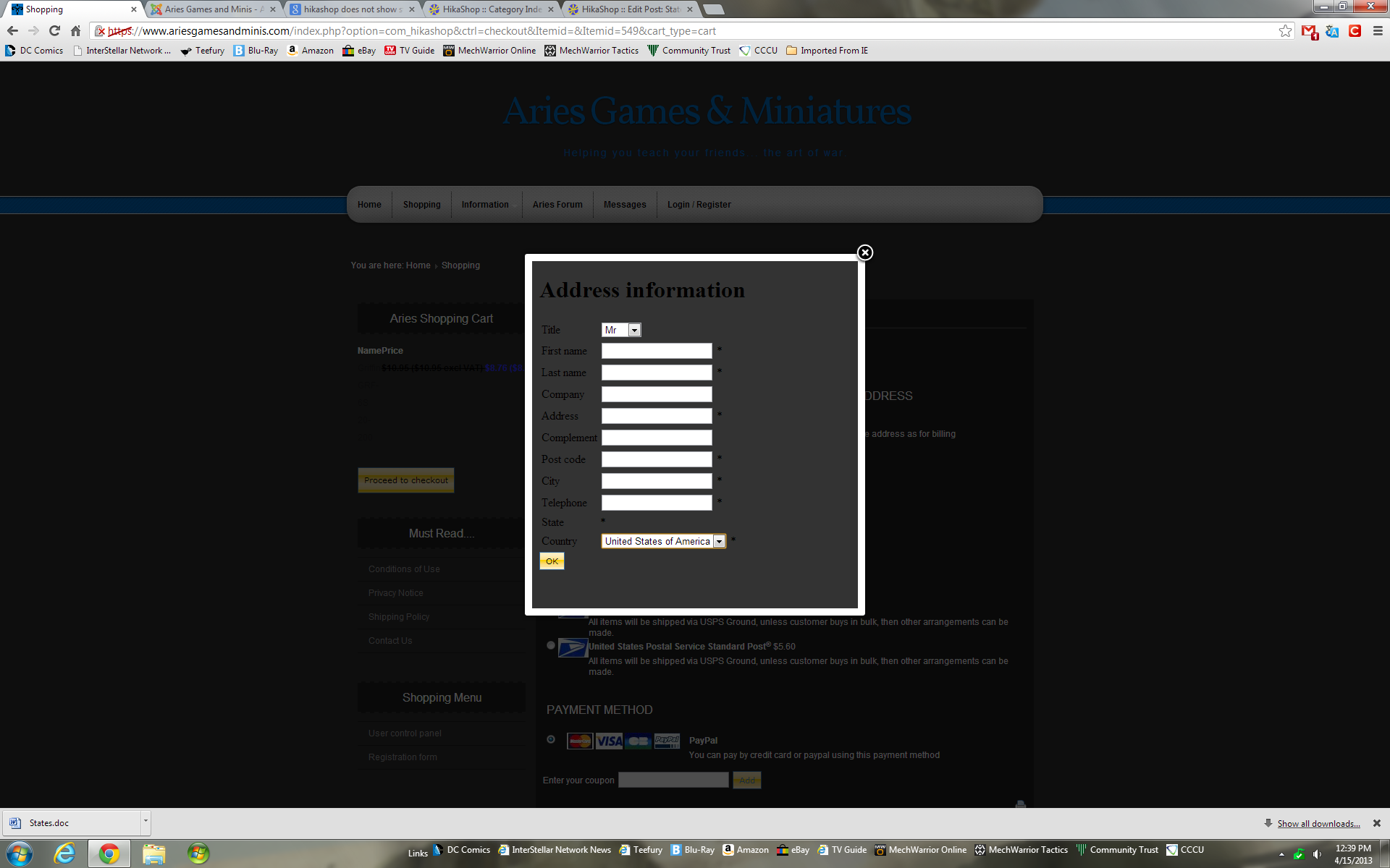

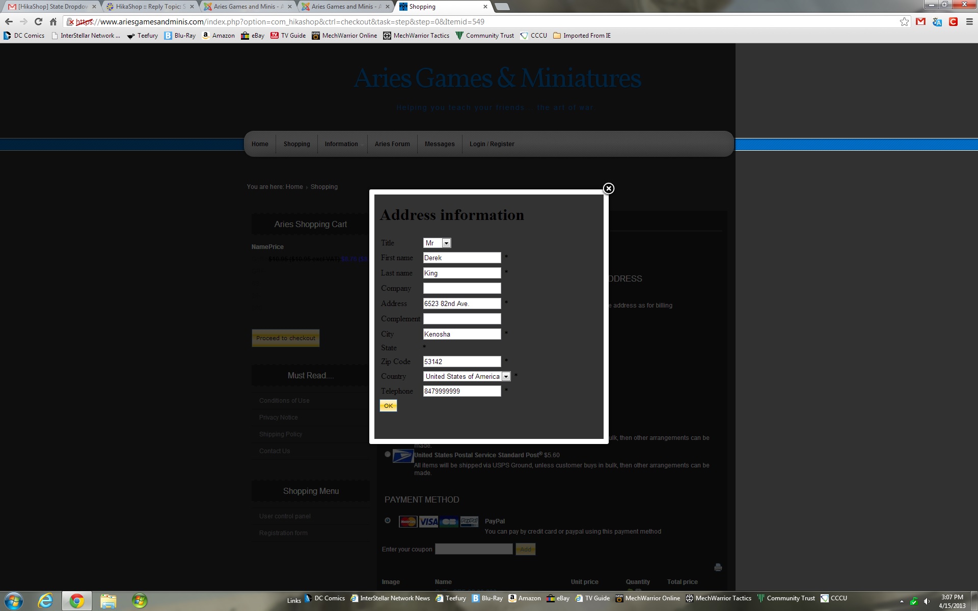

For some reason during the checkout screen, the state drop-down will not open when selecting United States as the country. I've checked the Zones list, and all states as well as the country listing for USA are enabled. How can I fix this...please help...thanks!
This is on Hikashop 2.1.2 essentials.

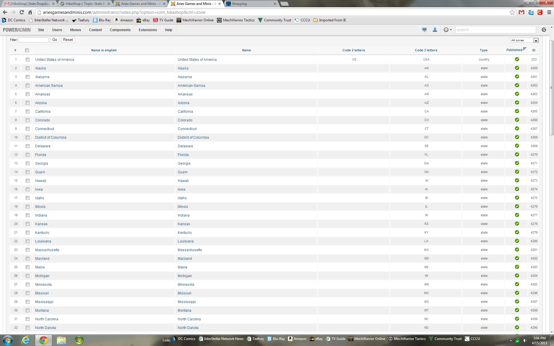

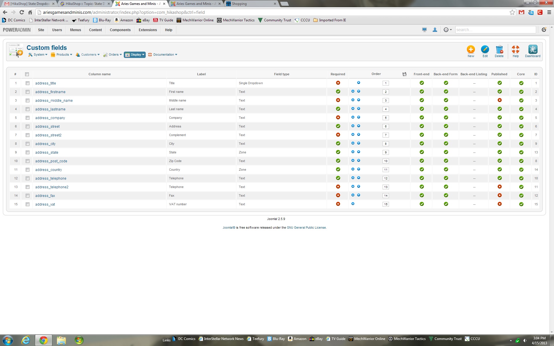

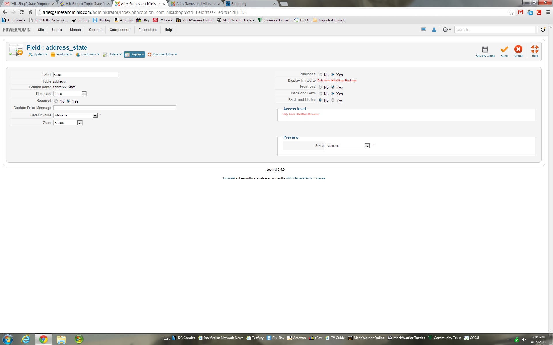

Ok...I found what you asked me to...and they are already set as default. I've attached some screen shots I think may help...
I've enabled & disabled all the items in the images...and still my states do not show up.

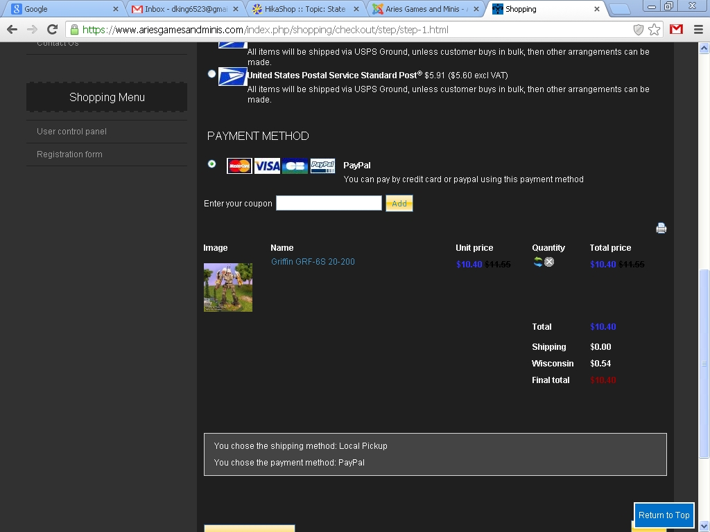

Ok...I've done something wrong, but I don't know how to correct it. I tried to make an order for myself to make sure it would charge tax all the way to the PayPal screen. My tax rate would be 5.5%...so we will use that in the example below.
Problem #1...With the item in my cart at $10.40, my shipping address correctly entered along with Local Pickup selected for shipping, tax is coming out to $0.54 when it should be $0.58. (Image #1)

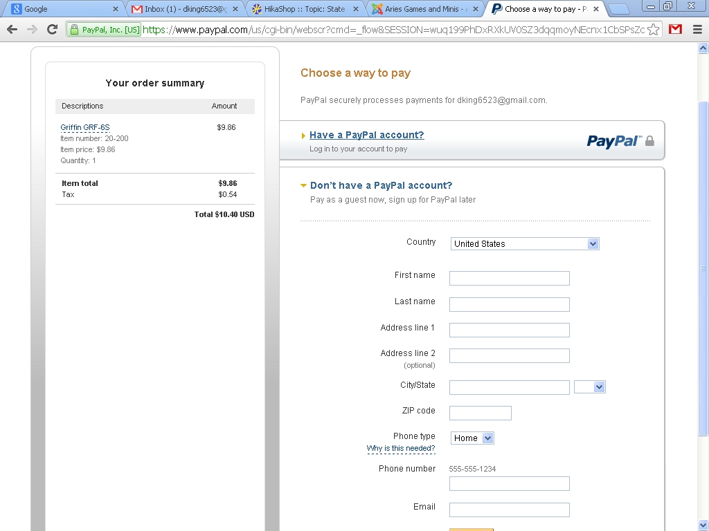

Problem #2...When I go to pay through PayPal, it is showing the item at $9.86...not $10.40, but it did transfer over the (incorrect) tax rate of $0.54.
How do I fix both. If you want me to start a new thread...I will.
Last edit: 13 years 4 months ago by Dragon41673.

13 years 4 months ago #102241
Ok...I figured out Problem #2. It was crediting the tax as it was set for local pickup, so after I made that not an option, tax was being calculated properly.
I still need help on #1 though.
