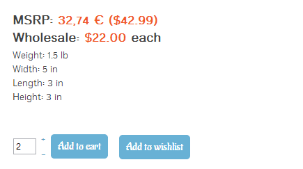

How do you remove the first currency from MSRP on front end?
I manage to change the language file to read MSRP but I need to delete the euro price and leave the dollar price on the product page: 32,74 € ($42.99)

13 years 4 months ago #99590
In the backend, you can set the "Retail price" for your product.
The default currency would be printed just after the input box.
If the currency is not the right one, it means that you have to re-save your configuration in order to store the right currency in the database.
Most of time, if the default currency is not published, HikaShop would use the first published one, but it does not work like this everywhere.

The backend only shows $USD next to the product price. I only have one currency I'm using to display.
The config shows $USD only.
I saved again and nothing changes.

Yes you can only set the retail price in the main currency, but in the frontend it's displayed in the customer's currency.

I don't have a currency converter active on my site. How can I remove the euro currency? This only happens when retail price is active.

And which currency is displayed in the backend for the MSRP option ?

Hi, main currency is set at $USD. There is only one to select. I use no other currency.

In the view "product / listing_price" can you try to replace:
$currCurrency = $app->getUserState( HIKASHOP_COMPONENT.'.currency_id', '1');
By:
$currCurrency = $app->getUserState( HIKASHOP_COMPONENT.'.currency_id', $mainCurr );

Hi, yes that works. Will this be a fix for the next release?

Yes, it will.
