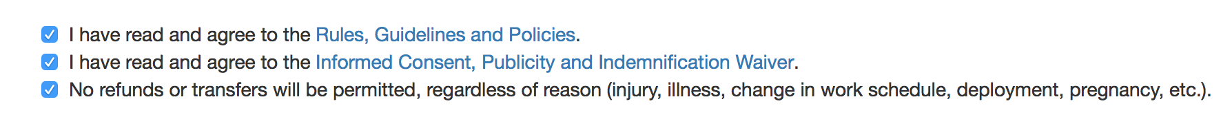

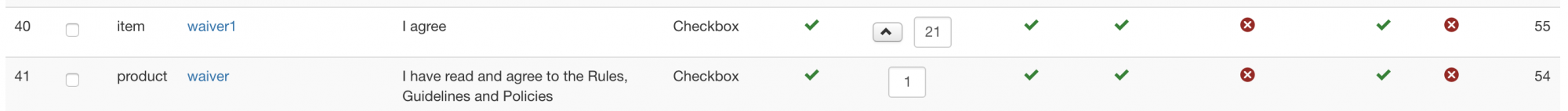

Hi guys,
Hate to be dense here but I can't figure out how to do this and allow a custom link for each event (the waivers are different for each event host).
1. I have tried the following in the screenshot, but can't seem to make it work (appear) in the checkout...
2. How can I make a hyperlink like the below during checkout?
Thanks much. Chris
  • Posts: 86104
  • Thank you received: 14203
10 years 4 months ago #237260
In your case, I think I would only create custom fields of the table "order" and restrict each one to the products corresponding to them. That way, they would show on the checkout only if the corresponding products would be in the cart.
