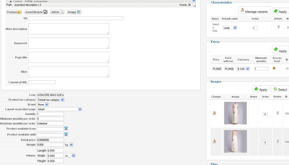

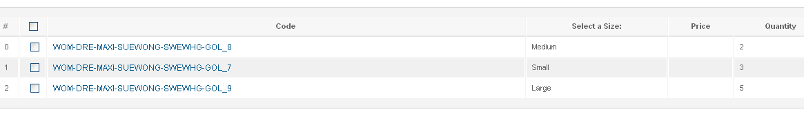

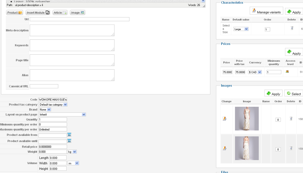

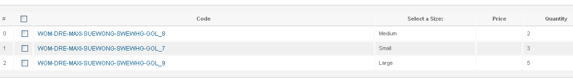

13 years 4 months ago #100425
I've attached a product page screen shot and a variant screen shot. Not sure if those are the pages you need.

I was thinking that I should put the total amount of all the products (6) on the main product and then the quantity for each product size (2) in the characteristics? Is that not how it should work?
I am trying to get from you the proper way to do this so that it works correctly.
Thank you!!
  • Posts: 86112
  • Thank you received: 14209
13 years 4 months ago #102024
You can potentially put the total quantity in the main product.
You can also leave it unlimited.
If you fill the quantity for each variant, it doesn't matter. If you set the total quantity, the system will update it. If you don't then it won't do it. But that has no influence on the product availability since it's the variants quantity which is used.
