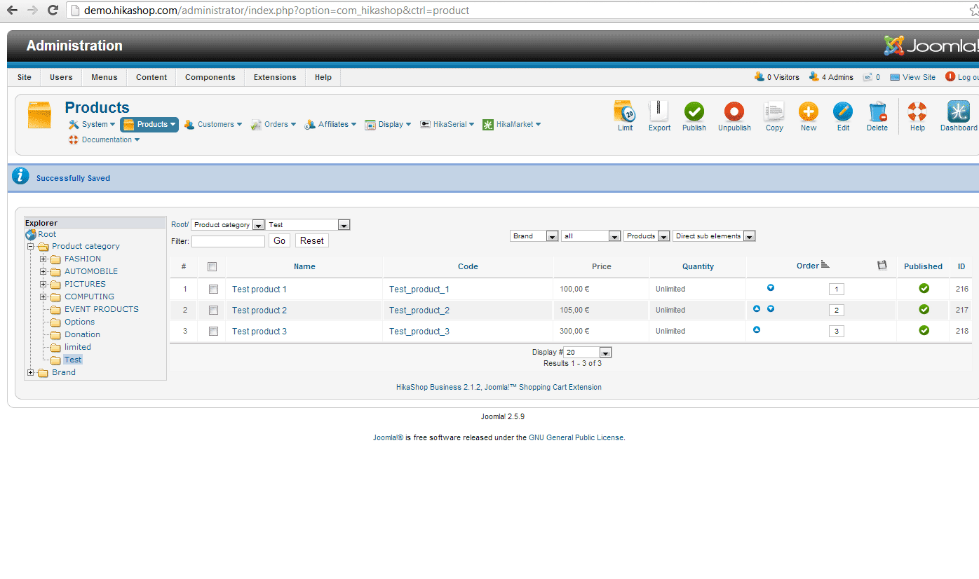

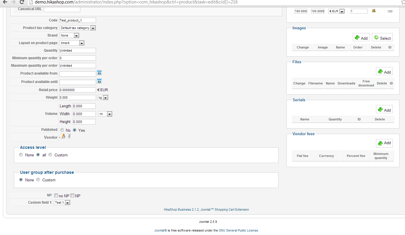

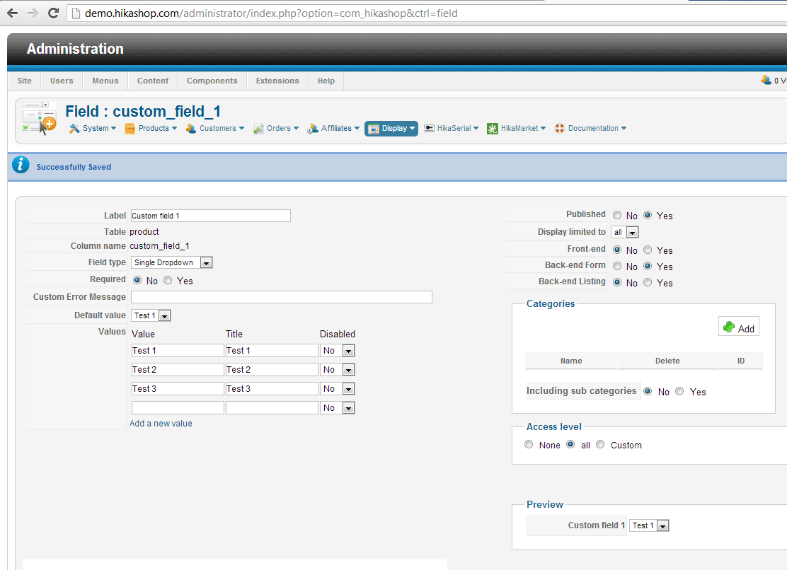

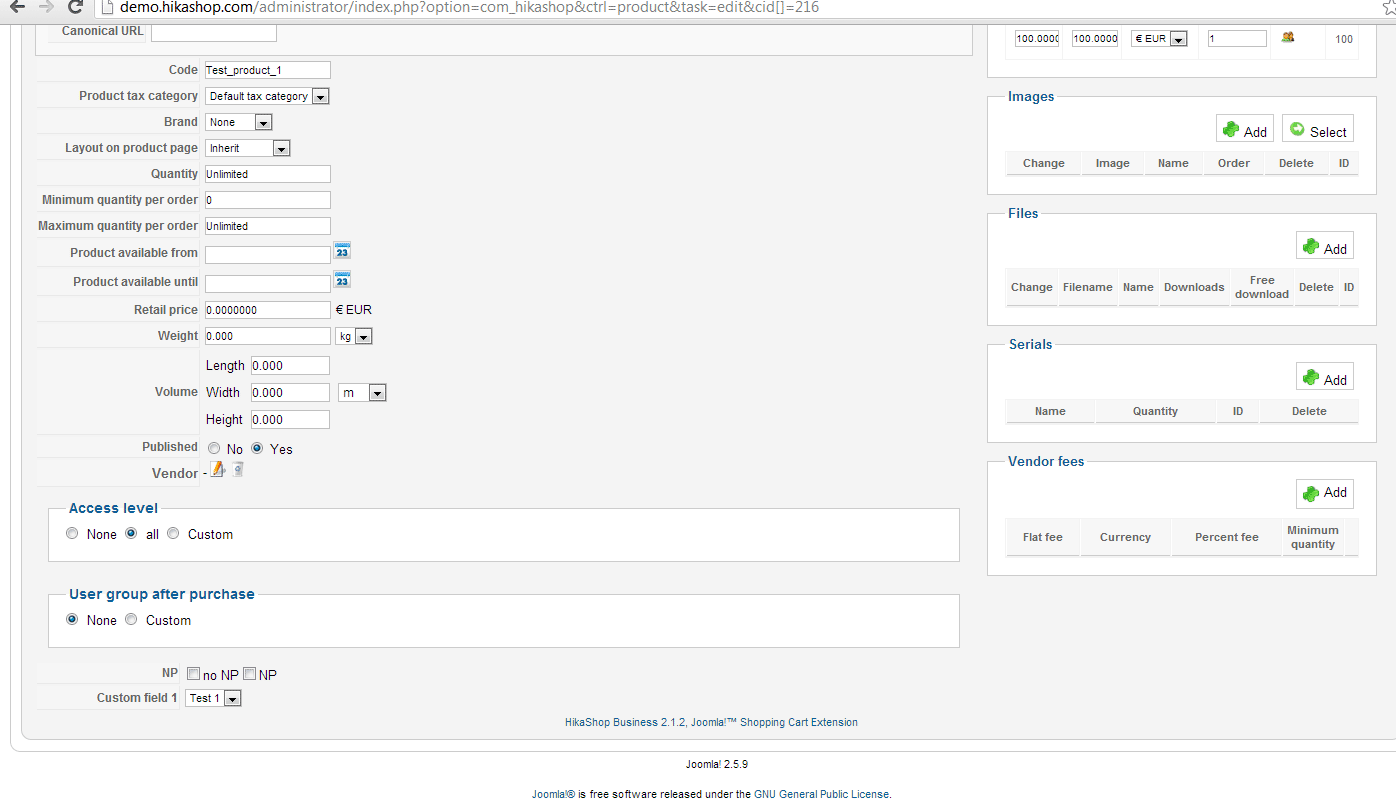

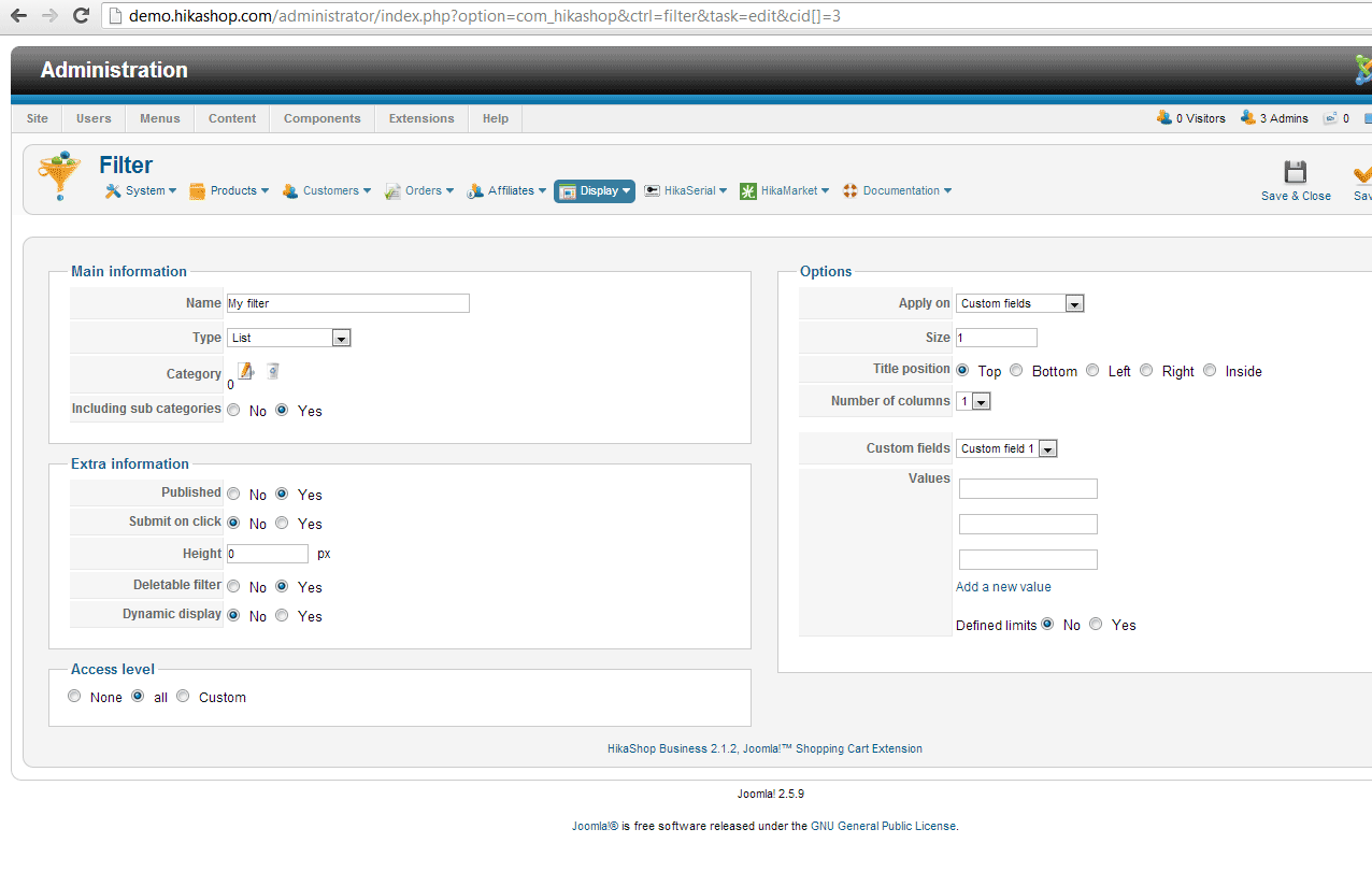

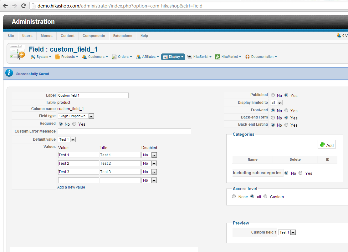

1. Create custom field

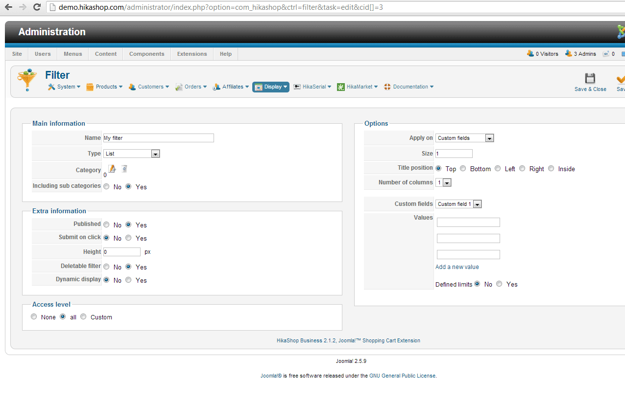

2. Create Filter with this Custom field

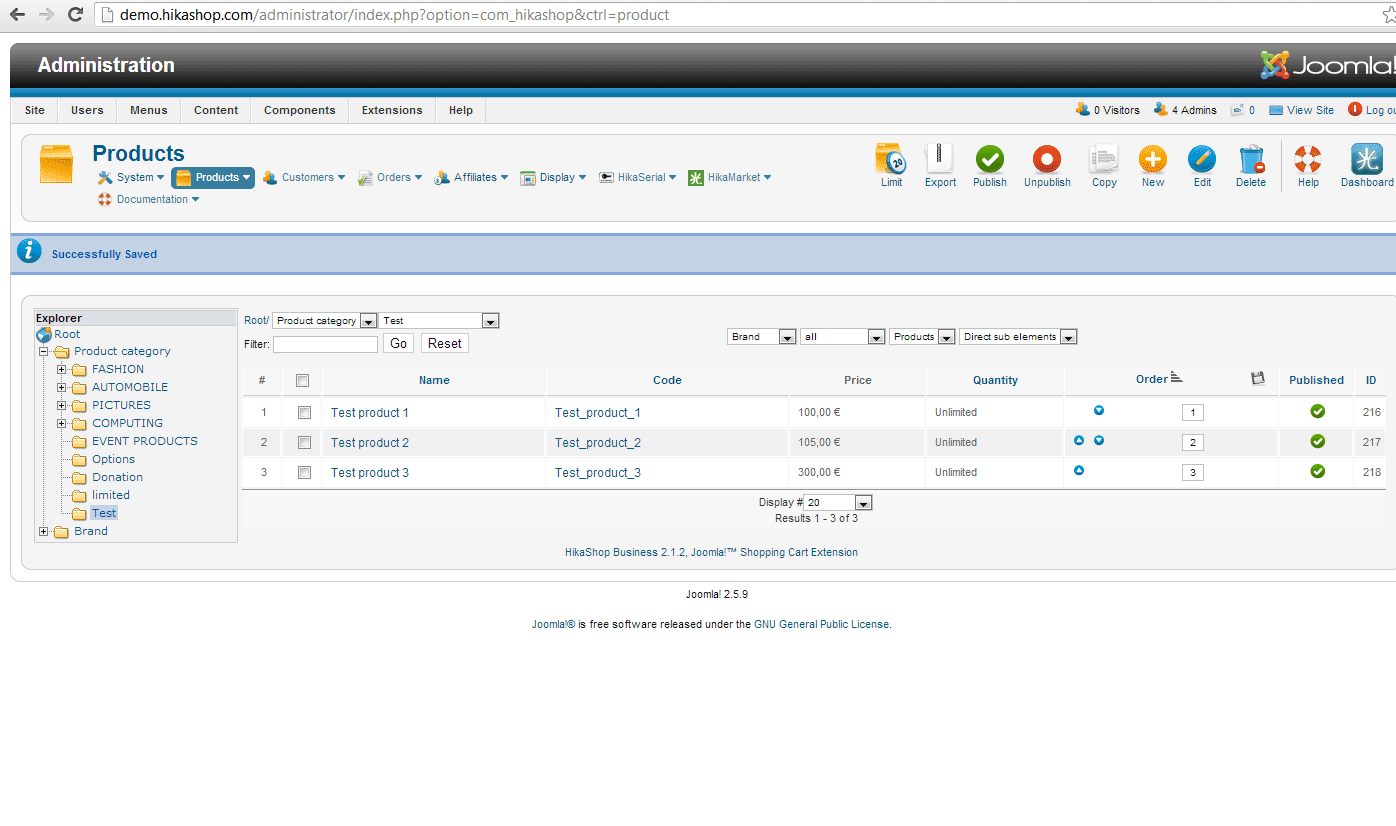

3. Create test category and products with this Custom field. Product 1 & 2 with "Test 1" value and Product 3 with "Test 2" value

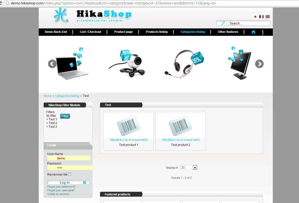

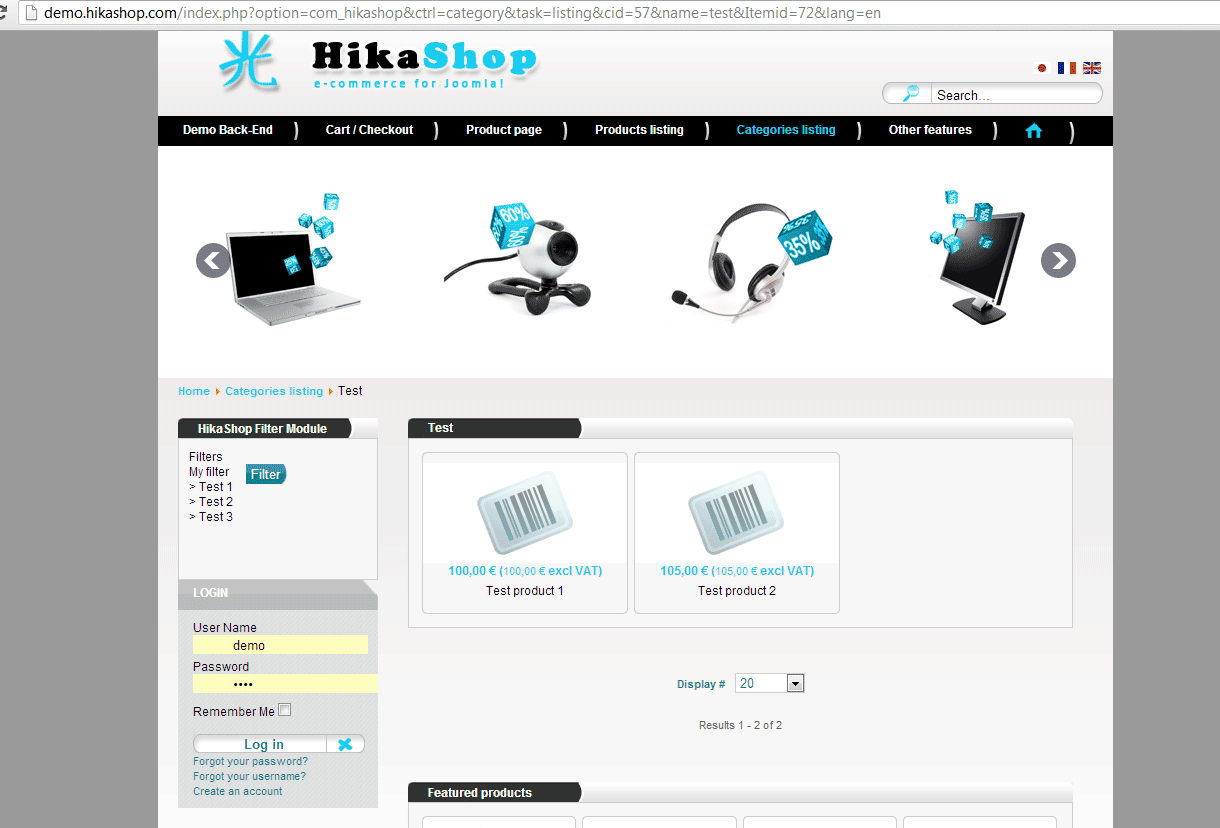

4. Apply filter on a site page
It works, when I press for example "Test 1" in filter module. It shows Product 1 and Product 2. But how to delete filtering and show all 3 products again?

13 years 4 months ago #100570
I thought it's "Deletable filter" option, but it's set in Yes and nothing changed.

13 years 4 months ago #100571
And second part. When I use filter, I can't understand then what option I selected: Test 1, Test2 or Test 3. Can it change color, or maybe display pic near selected filter option or something else?

13 years 4 months ago #100592
1. Regarding the "deletable filter", if that option is turned on, when a filter has been used, there is a delete icon next to it in order to cancel the filter.
2. The filter will just search for products which have a chosen "characteristics/configurations".

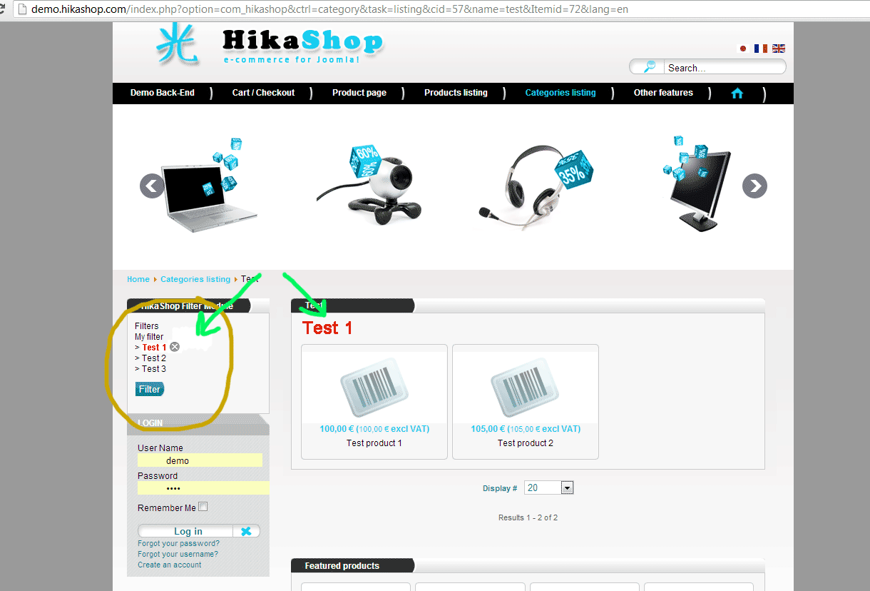

13 years 4 months ago #100596
Mohamed Thelji wrote: Hi,

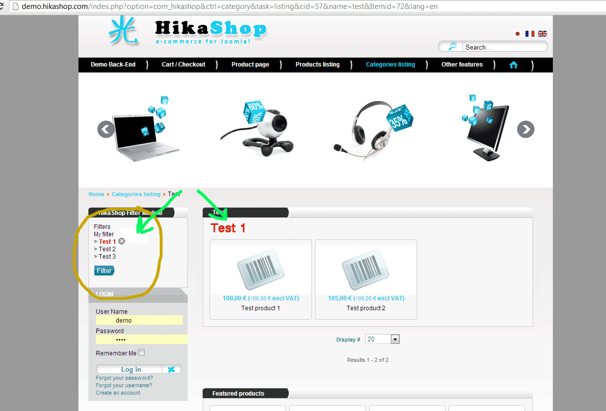

But as you can see on the last screenshot, there is no any delete icon near "Test 1" option :(
13 years 4 months ago #100615
I tested it and it seems to be working fine for me, did you used your filter ? the delete icon will show only if your filter has been used.

13 years 4 months ago #100639
Mohamed Thelji wrote: I tested it and it seems to be working fine for me, did you used your filter ? the delete icon will show only if your filter has been used.
I think it has been used. Because when I click "Test 1", it shows "Test product 1" and "Test product 2". When click "Test 2", it shows only "Test product 3", as I need.
Hard to understand how to config it correctly :(
13 years 4 months ago #100738
I think that you should maybe try it again with the type of your filter set to checkbox :).

Thank you. As checkbox I can delete it.
And now can I do this?:
When click in filter -> Show in main part, what I selected in Filter.
And second: do not hide other options in filter. So I always can change it by one click (not first delete filter and select again).

The list or checkbox type without the "deletable filter" hasn't visible signs what the customer had selected in the filter. It confuses the customer :(
Is it hard to make selected option in filter bold or change color?

13 years 4 months ago #100965
find in filter.php code and add $tsvet (css class). Now it changes color, when click :woohoo:
