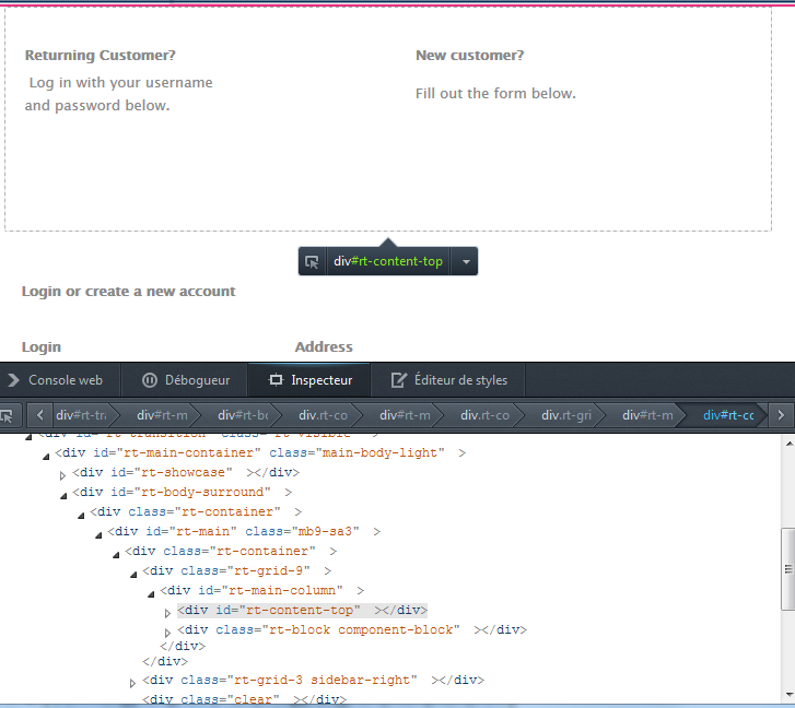

But it looks like there is a lot of space between the checkout fields and the module on the top. is there anyway to lessen this gap?
shopisabelle.com/index.php/checkout/checkout
13 years 4 months ago #101403
The space come from your custom module, as you can see in the screenshot.
Thanks to follow this tutorial to see how to solve this problem.
www.hikashop.com/fr/support/documentatio...ize-the-display.html
