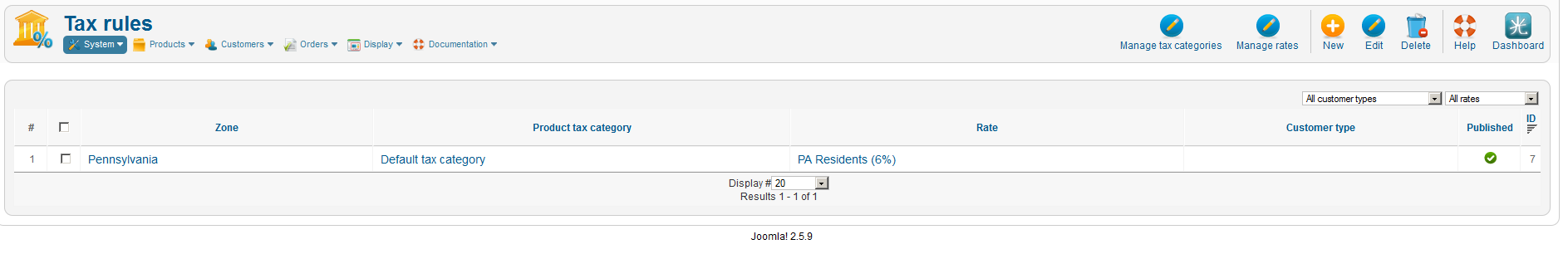

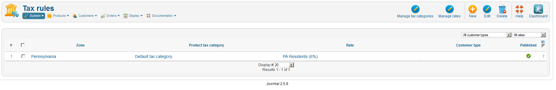

Hello, I have a tax set up such that only people who purchase in the state of Pennsylvania, US pay a tax. When a user checks out the store is assuming first that the user is from Pennsylvania and shows the default tax. I need the checkout to show NO tax until the user fills in that they are from Pennsylvania and then the tax shows up. How do I adjust this so no tax is the default and only Pennsylvania will show the tax?
This is the site mvs005-002.directrouter.com/~nighteye/checkout2/product/listing If you go here and click add product you will see the tax for Pennsylvania is there right away before the user creates their account settings.

Firstly did you set your tax zone to "Pennsylvania" ?
  • Posts: 34

thanks for answering.
yes set to Pennslyvania

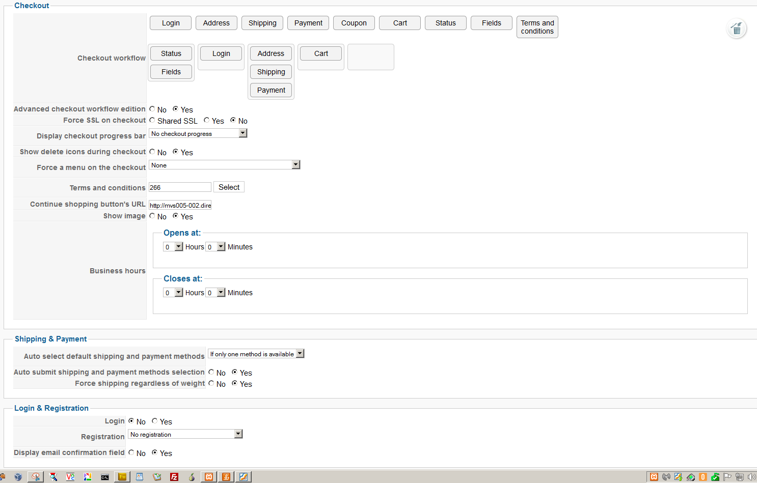

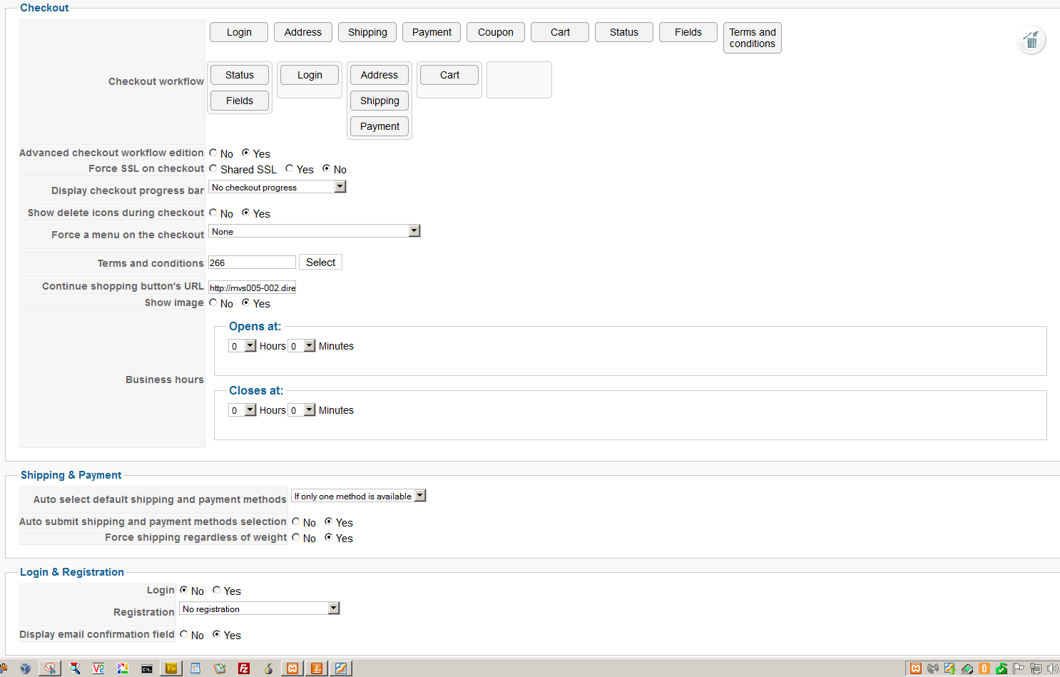

Ok, I've done some test through your website and I think that your problem is coming from the fact that you have set the cart step 2 times through your checkout workflow "Hikashop->System->Configuration->'Checkout'".
So can you set just 1 cart step and after your other steps ?

OK I have placed cart one time at the end.

13 years 4 months ago #101983
Just thought to add this too.
13 years 4 months ago #101996
So how does it work with this checkout workflow configuration ?

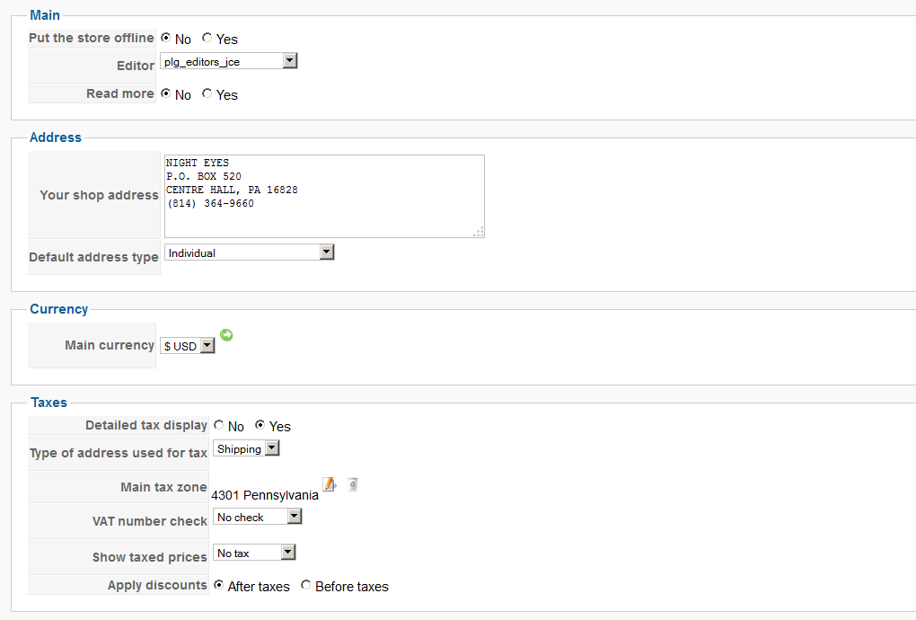

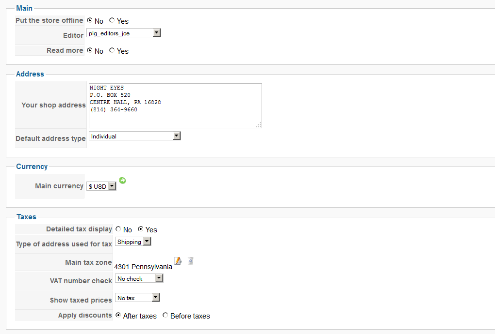

  • Posts: 86112
  • Thank you received: 14209
13 years 4 months ago #102030
You simply need to change your "main tax zone" option. That option is used when the user didn't yet enter his address to know what tax rule should be applied.
If you set you main tax zone option to a state/country outside the zones of your tax rules, the taxes won't display until the user enter his address in PA.

13 years 4 months ago #102048
That worked great. I changed value to US.
