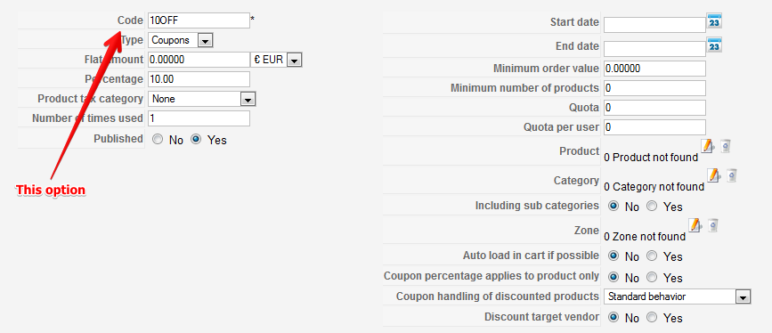

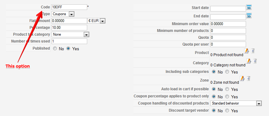

13 years 4 months ago #101937
It means that you're using a code through the "Code" option of your coupon that already has been used.

13 years 4 months ago #101969
The solution given by Mohamed is the correct solution, and his answers were correct too.
To have a reduction on an order you have to set a "coupon". The discounts are for products, not orders.
So with the option "Auto load in cart if possible" the reduction will automatically be applied, without entering the coupon number.
The error about the coupon code, is what you are calling the coupon "number". When setting up a coupon, they need a unique code.
And you can do all by yourself, you can too read the documentation and integrated documentation.
Auto load in cart if possible : When turned on, the system will load the coupon in the cart on the checkout if the coupon restrictions are matched without your customers having to enter its code.
