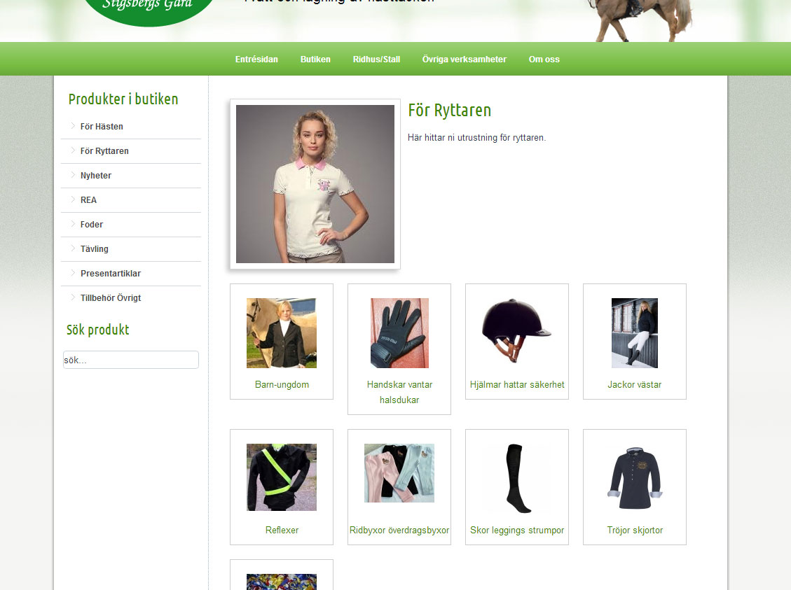

1. The left menu displaying product categories in the web shop is the menu I mean. I will try to see how you set it up in the demo site to get it right.
In your site this menu has the header text "Categories of products".
2. Yes I wanted to change the Categories of product- menu and have the different sub categories listed alphabetically. I sorted this out by ordering them manually in the backend even if that way is time demanding and not optional. You have to change it every time you add a new product category... :(
3. Thanks.
So I will play around with the settings a bit and hopefully I wont bother you anymore about these things. Hope I have cleared out things better now.

I have been watching the settings in your demo shop backend but I can't for my life solve how to set the left side vertical menu properly to get the styling added to it as I want it.
I have made a template menu in Artisteer and I have a class suffix that has to be added in order to work " sbg-vmenu" and I have added it under the Joomla Module for the menu and then also in the HikaShop module for the menu but I'm only halfways.
Now the menu displays as a list showingthe main categories (but not properly styled) then when clicking one of those categories in the menu it opens displaying the sub-categories and those are styled...
It looks weird the maincategories around the sub categories are not styled but the sub categories are so something is missing but no matter how I try to play around with settings I can't solve it.
So please can you gouys who knows this help me out?

Your suggestions partly solved the menu issue, at least for the sub categories listing. The main categories are still weirdly displayed.
I don't find how to style these.
The way I want it to look like is like this (when opening the shop):
The display of the menu is not set to all pages as I only want it to display on the pages that are under the HikaShop section.
I have tried to set up to display on all pages but then it obviously displays even on pages outside the HikaShop. Even if I'm using the Advanced Module Manager I can't find anyhow to filter out the regaular webs pages and display it on all pages under HikaShop.
The same applieas to the cart and the product search module, I would them displayed on all pages under HikaShop as well.
And oops now all products are displayed as free, all prices disappeared :(
Too much playing around and no real control, how can prices go away like this? I think I have checked all price display options and find nowhere to set up all prices as free.
Please need assistance with this.

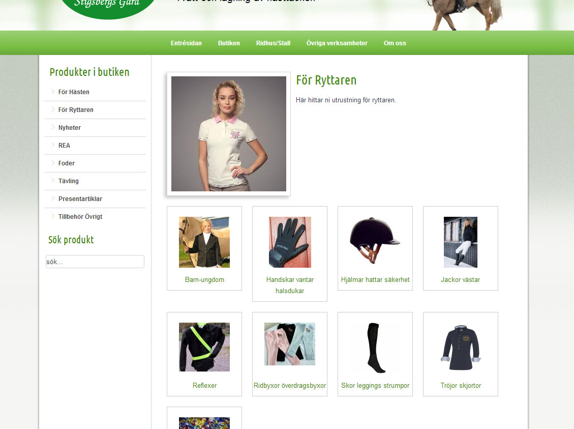

HI,
Strange you can't see the image it is displaying fine now in my browsers.
I upload it as well. I would like the me nu look exactly like the picture that actually is a screen shot when the settings are set to display only a static menu showing only the main categories.
As it is now it is showing all objects at the same time both main categories and sub categories and the styling of the main menu objects are corrupt.
Here is a typical product view where no left column modules are displayed for example the product categories menu, cart, product search.
www.gobbe.se/index.php/component/hikasho...ps-hjaelm?Itemid=146
  • Posts: 86112
  • Thank you received: 14209
13 years 4 months ago #103166
If you don't see the modules on the page www.gobbe.se/index.php/component/hikasho...ps-hjaelm?Itemid=146 that's because you restricted your modules to only some menus and that you didn't select the menu with the id 146 which is the one used on that page. Select it in the menu assignment option of your modules and they will display there too.
Regarding the categories listing module on the left, you need to change the option "show sub categories" to "no" in the HikaShop options of the module. You can find that by editing your module (id 156) via the menu Display->Content modules.
