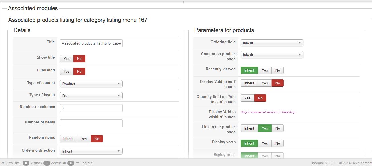

13 years 1 month ago #101755
You'll just have to :
- Edit your category listing content menu through "Hikashop->Display->Content Menus->'Your Content Menu'"
- click on the "Associated modules" link
- Then set the "Display 'Add to cart' button" option to NO.
Hope this will help you a little.
  • Posts: 4
13 years 1 month ago #102083
Am I missing something? I can't find the option
13 years 1 month ago #102090
As I told you, you'll find it through your category listing associated module, you'll just have to click on the "associated module" option's link :).
  • Posts: 4
13 years 1 month ago #102094
ah! got it! Thanks!

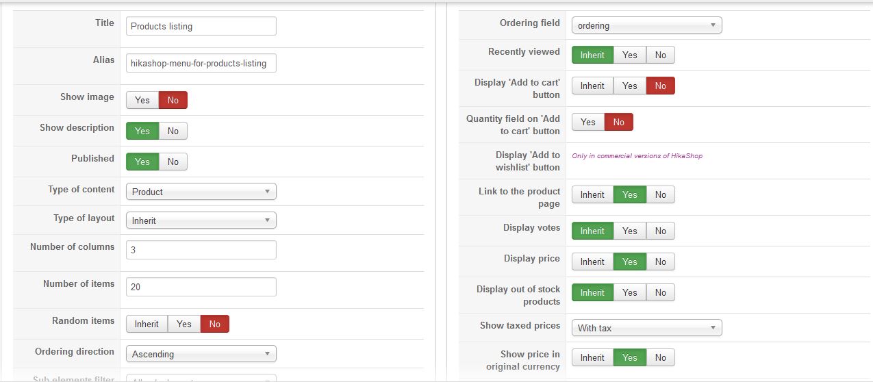

11 years 10 months ago #167524
Hi there,
I cannot turn off the 'add to cart' button on my products listing (not product page, but product listings page).
I have gone to Display > Content Menus > 'Products Listing' and from there disabled 'Add to cart'. But on front end the 'add the cart' button still displays. Please see attached. I cannot work out where I am going wrong. Cam you have a look?
  • Posts: 26357
  • Thank you received: 4068
11 years 10 months ago #167532
I guess you're editing the wrong menu.
In your website, the menu you are using have the id 106, not 167.
If you look at the "alias" of your menu, you will see that you are not using this alias while browsing your website.
The following user(s) said Thank You: boopoo
