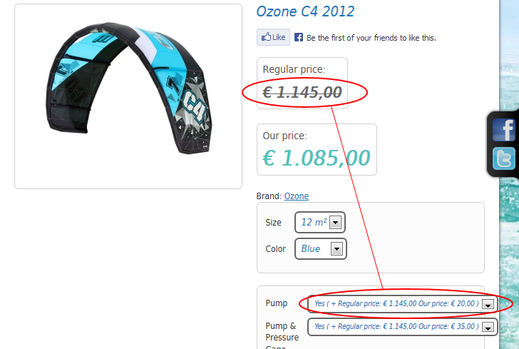

I am encountering the problem that on my site the MSRP for the main product shows up in the price for the product options. The product options do not have any retail price listed, and should just show up with their own price.
In the example picture attached the option 'Pump' should just be listed at its own price of €20. Instead it is listed as 'Regular price €1145,00 Our price €20,00' The Regular price that is named is the MSRP of the main product under which this pump is listed as an option.
What can I do to fix this?!
Could this isseu have anything to do with the edits to views discussed here ?
Kind regards,
Chris

No, it's not fixed.
If you look at this page , for example, you can see that the price of the options (pump etc.) are still listed with the MSRP of the main product in front of the option price.

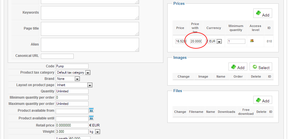

13 years 4 months ago #102885
Thanks for looking into this.
The strange thing is that on the products that are listed as the options have their price set to 0. (See the second attached screenshot in my original post.) The retail price that is somehow listed within the options, is the retail price of the main item (the kite in the link above) to which the options are added. If I add the same option to another main item the price of that other main item is listed in the option price.

13 years 4 months ago #102944
Add the line:
<?php $this->params->set('from','module'); ?>
at the beginning of the file "option" of the view "product" via the menu Display->Views and that should avoid the problem.

13 years 4 months ago #103025
Thanks for the awesome support! This fixed the issue completely!
