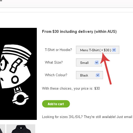

Is it possible to hide the positive symbol in the product options dropdown menu?

The positive symbol in the product options dropdown menu ?
Can you provide an screenshot or an image. I don't see what you're talking about.

You have to edit the view "product | option". You will find the line:
$text.=' ( '.($positive?'+ ':'').strip_tags($this->loadTemplate()).' )';
So you can replace it by
$text.=' ( '.strip_tags($this->loadTemplate()).' )';
To remove the "+" before the price.

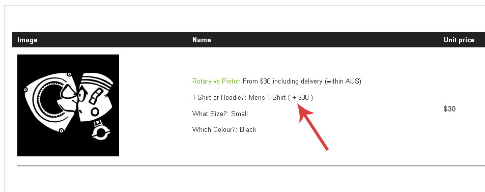

Is it also possible to remove it from the text in the shopping cart?

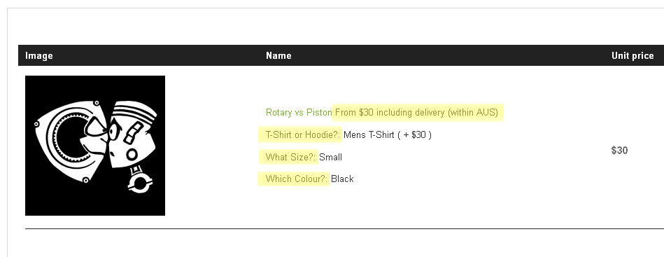

Lastly, I would also like to remove the text from the shopping cart which is highlighted in yellow on the image below. I think the cart would look a lot simpler and easier to read if this text was not there. Is this possible?
Thank you so much for all of your help. Your positive attitude and polite responses are much appreciated.

Same procedure, another view : "checkout | cart".
Look at the line:{code]echo ' ( + ';[/code]
You can customize the rest of the view in order to remove the content you don't want to display.
