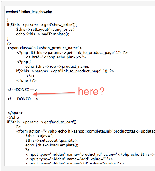

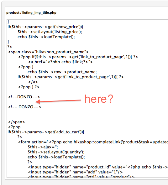

  • Posts: 74
15 years 6 months ago #10502
Is it possible to add the custom fields to the "views - front-end - listing_img_title" view ?
I can see where it goes, but when I copied the code from the "views - front-end - product - show" view it broke, of course.
Any ideas?
  • Posts: 86183
15 years 6 months ago #10512
You can try to put the code inside the form few lines below. But that will probably break too :)
  • Posts: 74
15 years 6 months ago #10687
I think it will as there isn't provision in the code to pull in the variables, and Im not at a level to do this depth of customisation.
Would be really good to be able to show any of the product info in the products list or grid.
I have for example;
[ picture ]
Title of product
Artist
Year
Add to cart
Would be nice. ;)
  • Posts: 86183
15 years 6 months ago #10688
If you just want to DISPLAY custom product fields values in the listing, you can easily do so by adding something like this:
echo 'CUSTOM_FIELD_LABEL : '.$this->row->CUSTOM_FIELD_COLUMN_NAME;
Where you can replace the CUSTOM_FIELD_COLUMN_NAME and CUSTOM_FIELD_LABEL by the values of your custom product field.
  • Posts: 74
15 years 6 months ago #10698
worked a treat!
thank you
Similar question, can I display the product code as well, what is the variable name for it , or is there a back end way to display the product code on the product detail page?
