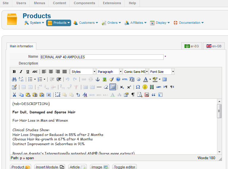

I installed Joomfish on my site
everything translated, except the products' names and description :ohmy:
The attached photo represents two tabs , one for arabic and one for english
i already put the translation in both of them, but still no changes

13 years 3 months ago #104991
Please reinstall HikaShop (do not require to uninstall it, just install HikaShop again for an update, even if the version does not change).
It will detect that Joomfish is installed and will copy the XML files for it.

13 years 3 months ago #105000
If you don't see the translations that you created in the joomfish backend translations listing, it means that you're missing the integration between HikaShop and JoomFish because you installed JoomFish after HikaShop.
If you don't want to install again HikaShop (so that it can add the integration files), you can add them manually by copying the files of the folder administrator/components/com_hikashop/translations to the folder administrator/components/com_joomfish/contentelements/
