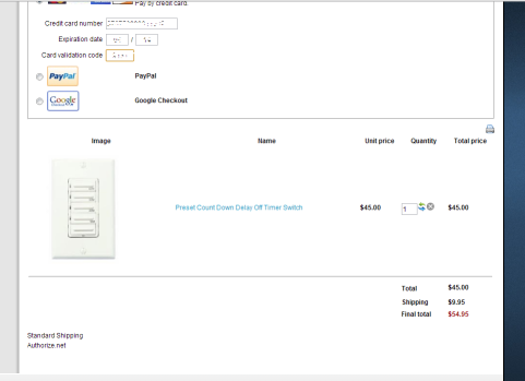

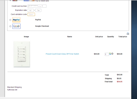

Seems like something is missing...
On the view cart/checkout page, should there be a continue button so that after address/payment info, etc...is entered, the customer can proceed?
Thank you

And if you have some information, like your website, a screenshot of your checkout workflow, a screenshot of your checkout where the "continue" button seams missing. It will help us to help you.
Best regards,

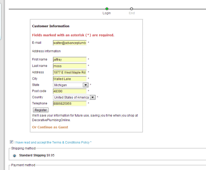

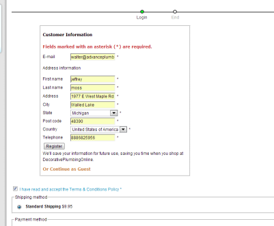

  • Posts: 223
13 years 3 months ago #105319
see attached....
site is decorativeplumbingonline.com
i have pm'd backend access to you
  • Posts: 26384
  • Thank you received: 4077

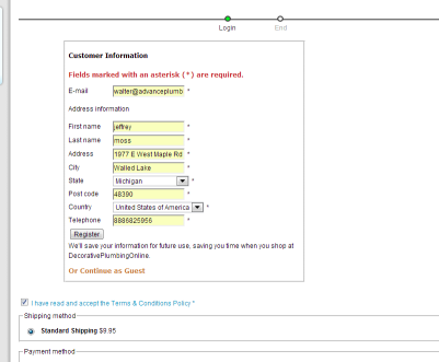

13 years 3 months ago #105321
But, if the user is not logged and the "login" step is display in the checkout. You won't have any error message. At this moment, the user have to use the "login" or the "register" button to continue.
It is your case. You have a button "register" just below the subscription form.
  • Posts: 223
13 years 3 months ago #105322
yes, but the reason we chose hikashop was because we were told by Nicholas that guest checkout was an option. we do not want to require customers to create an account to purchase. if need be, i will find the forums post(s) from nicholas indicating that an account WAS NOT needed to purchase/check-out.
  • Posts: 26384
13 years 3 months ago #105324
At this moment, you have to remove the "login" step from your checkout workflow and just use the "address" one.
As you can see, there is a button "register" and a link "or continue as a guest"

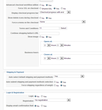

  • Posts: 86112
  • Thank you received: 14209
13 years 3 months ago #105785
I think that there is a misunderstanding here.
If you change the "registration" option of the configuration to "no registration" you will indeed be able to have a guest checkout: that means that you won't have any user account created for the user during the checkout. That's what the commercial edition allows (among other things).
That doesn't mean that you can remove the login view from the checkout. You still want it in order for your customers to be able to enter their address (which is what you want), but you don't have anymore the "username", "password" fields that you have in "registration" mode since no user account is created anymore.
  • Posts: 223
13 years 3 months ago #105814
It would seem that what you are Jerome are saying are two different things...which is causing the misunderstanding...he said the "login step should be removed from the checkout process....
"At this moment, you have to remove the "login" step from your checkout workflow and just use the "address" one.
As you can see, there is a button "register" and a link "or continue as a guest""
You seem to be saying that it should NOT be removed, but that I should simply change the name of the button...so a customer will then have no option on the checkout page to create an account, correct?
  • Posts: 86112
13 years 3 months ago #105854
That's correct.
If you remove the login view, you need to remove the address view, and then you don't get any information about the users. Both views are linked together, you can't have one without the other so what Jerome said was wrong.
And yes, users won't have the option to register since it will be a guest checkout.
However, if you still want to give them the possibility to register, you can just add a link to the Joomla user registration page and the users will be able to register if they want before proceeding back to the checkout.
