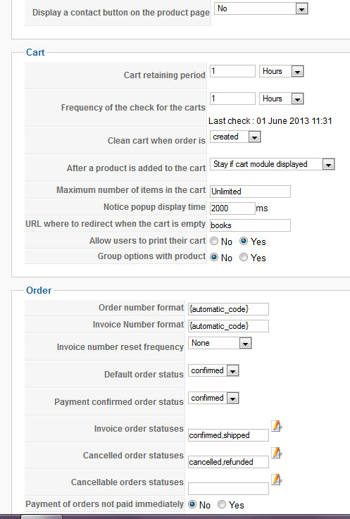

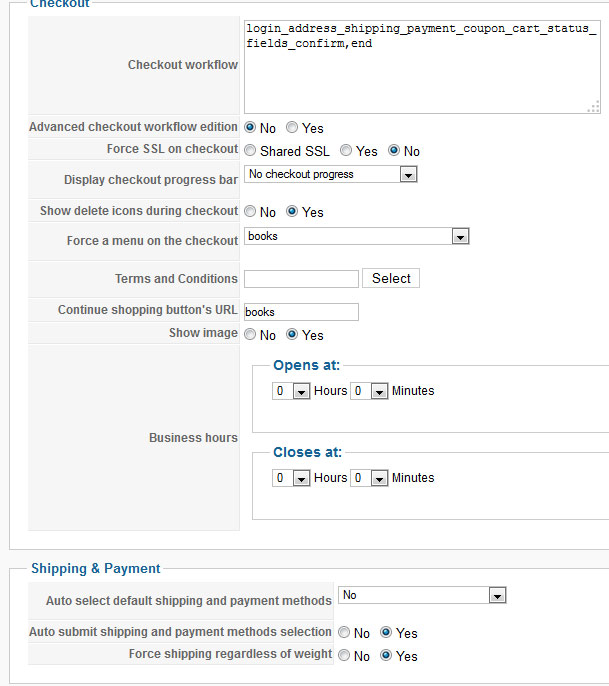

We need more information to be able to help you.
How did you configure your shipping methods ? Could you provide some screenshots ?
How did you configure your checkout ? Can you provide a screenshot of the checkout tab of the configuration ?
Can you give a link to your shop so that we can look at your checkout ?
