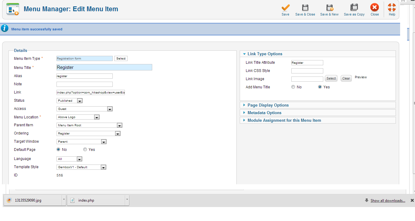

  • Posts: 71
13 years 3 months ago #107000
here with, i had attached the screenshot.
Thanks for your help.
  • Posts: 86108
  • Thank you received: 14209
13 years 3 months ago #107187
My suggestion about turning off the SEF was just to confirm that it works in such case, not a permanent solution of course.
You didn't say if it worked ?
I see that the register link that you have there was added manually.
So I recommend to simply change the link that you added to use:
gemboxjewellery.com/index.php?option=com...iew=user&layout=form
And then turn back on the SEF and that should not produce that 404 error.
