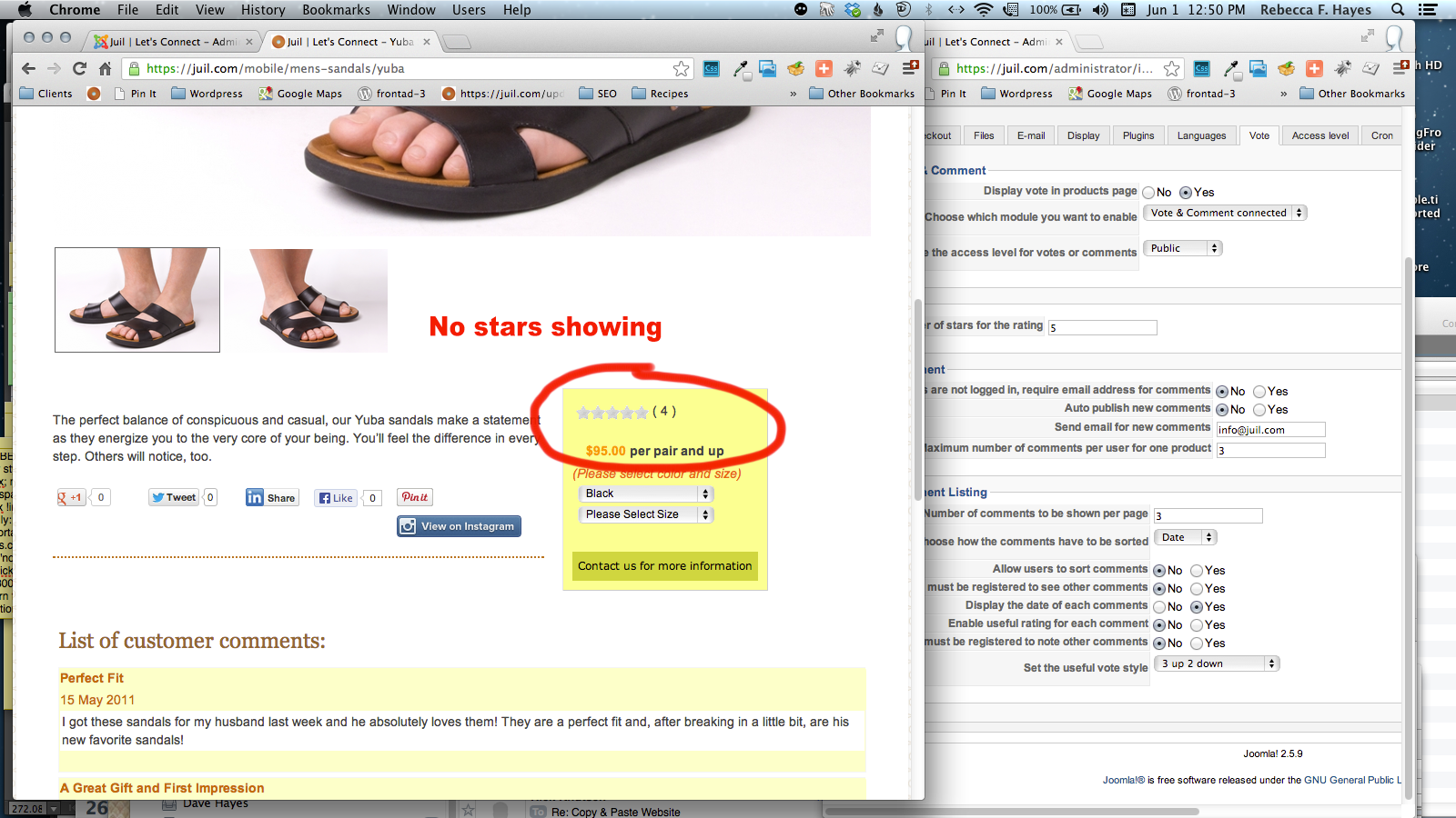

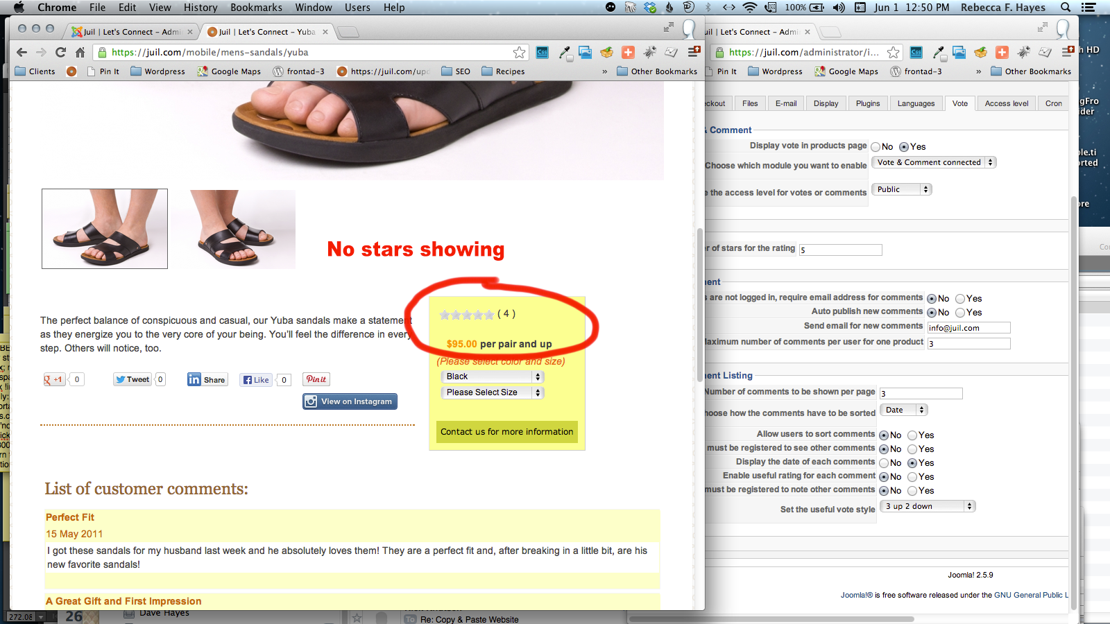

One more problem, the gold stars in the vote display is not showing. I thought it was an issue with the sandbox site being in a sub directory, but I don't think so. Please see this.
juil.com/mobile/juil-womens-selections/gaia
shows on current site:
juil.com/juil-womens-selections/gaia
13 years 3 months ago #107012
You mean in the comments listing ? (because the stars to vote are working fine).
They should be displayed, have you edited the view "vote / listing" ?
The vote previously passed were with the option "vote & comment connected" enabled ? If not, so it's normal.
  • Posts: 34
13 years 3 months ago #107257
The stars show on the original site, with exactly the same settings. They do not show on the mobile site. Please see attached. The client needs to see the the rating (if it has 5 stars on average). Thanks.
13 years 3 months ago #107376
Can you give me a link where the stars are not showing ?
Because on the page: juil.com/mobile/juil-womens-selections/gaia they are showing properly
And the link: juil.com/juil-womens-selections/gaia return a 404 error.
