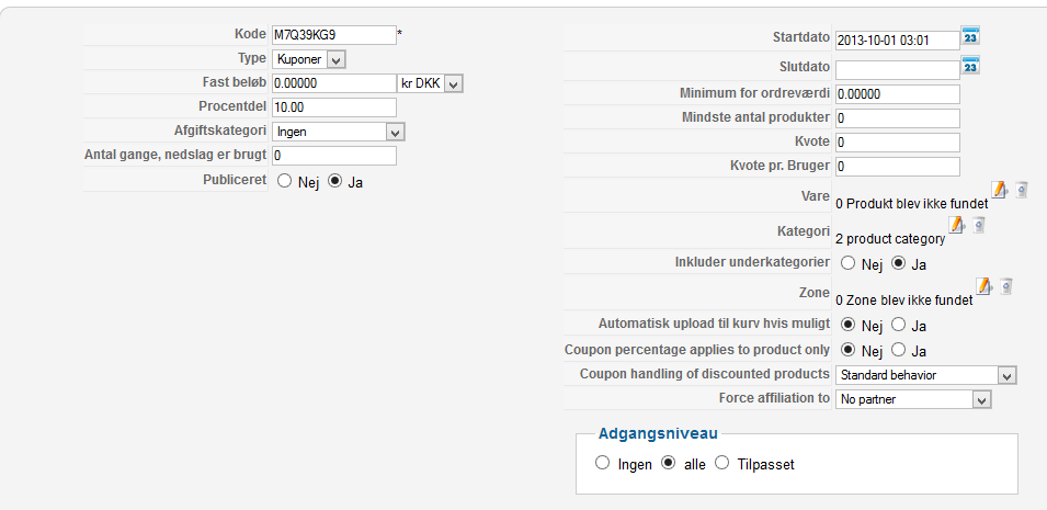

I tried to create a simple coupon, nothing fancy just 15% on whatever customers order. I used the default tax category that is set to 21%.
All works fine if i dont use the coupon, then it shows the correct tax, shipping cost etc., but when using the couponcode then i get weird amounts for the coupon and (probably connected to that) the tax.
I have a product that is priced including tax for € 14,95.
The coupon is supposed to be for 15%, so i expected a discount of €3,14 instead it shows €2,71 ?!?!
Please can someone help me understand how this works or what i do wrong.

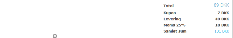

12 years 10 months ago #128171
i have the same problem ...
any idea why it happends ?
12 years 10 months ago #128181
I think that you'll probably have to change the value of your "Apply discounts" option through "Hikashop->System->Configuration->'Main'"
The following user(s) said Thank You: jesper
  • Posts: 171
  • Thank you received: 4
12 years 10 months ago #128196
thanx that was it.. changed and did correct right away :)
