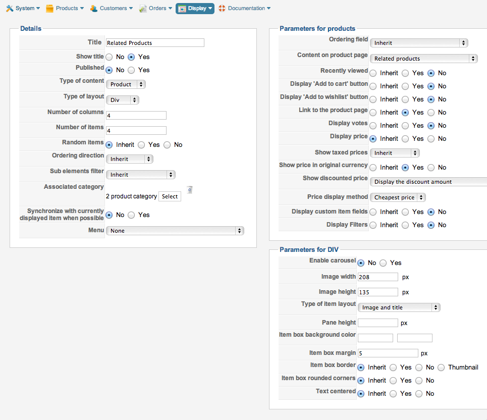

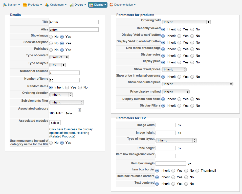

Also, we are about to add related products.
Our Joomla! menu items are assigned Products listing. And the Content menu associates the required category.
What is the best way to always show related products on the product page ? Do we use an associated module in this instance ?
We have created a 'Related Products' Content module, and associated it, but it did not display.
In config : 'Modules to display under the main area' is set to 'Related Products' - published/yes
Do Hikashop Module still require a Joomla! template position ?
Screenshot of a content module and related content module attached.
