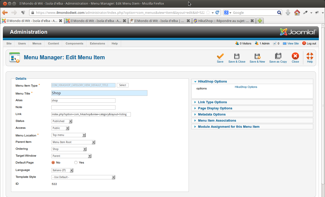

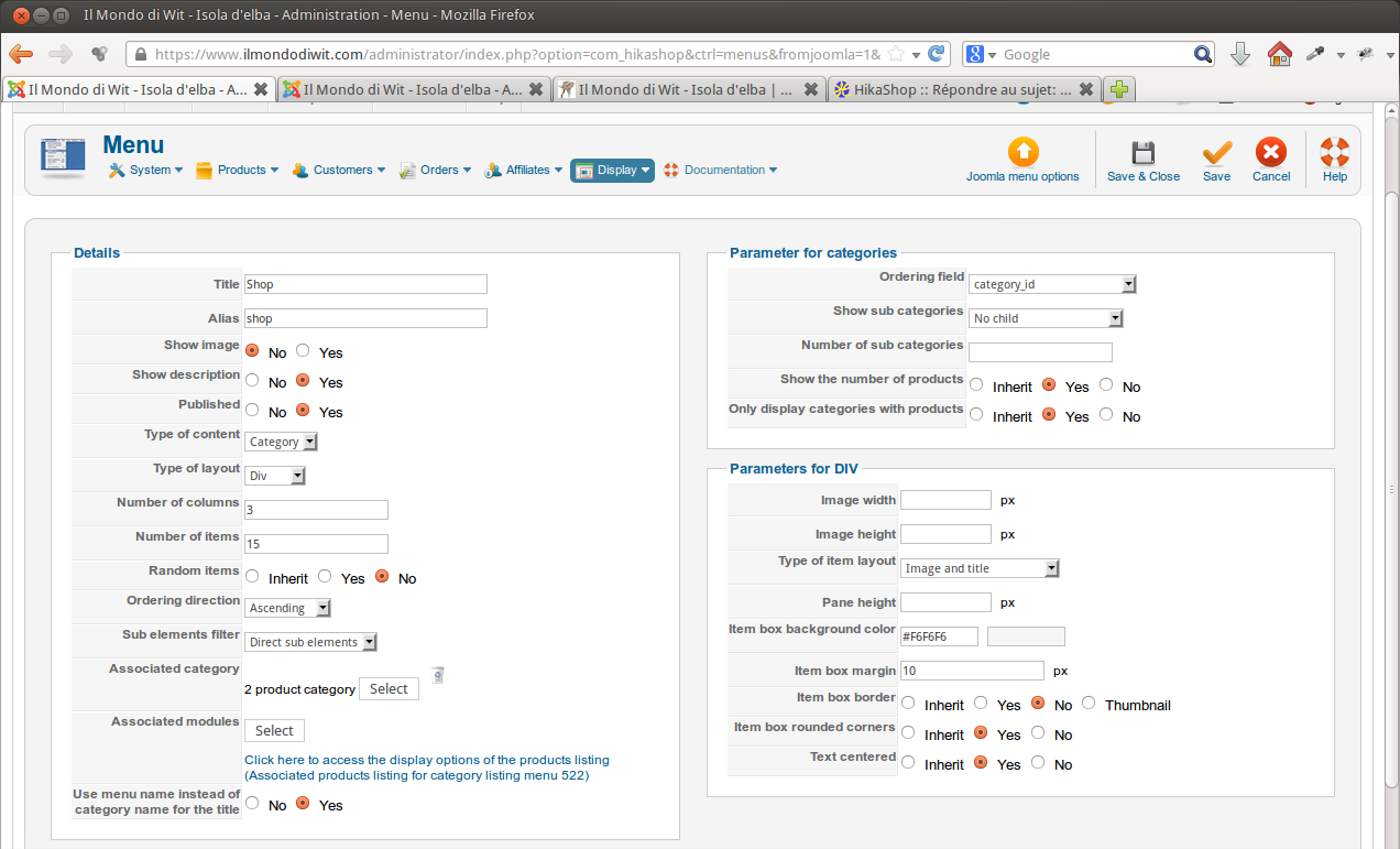

  • Posts: 75

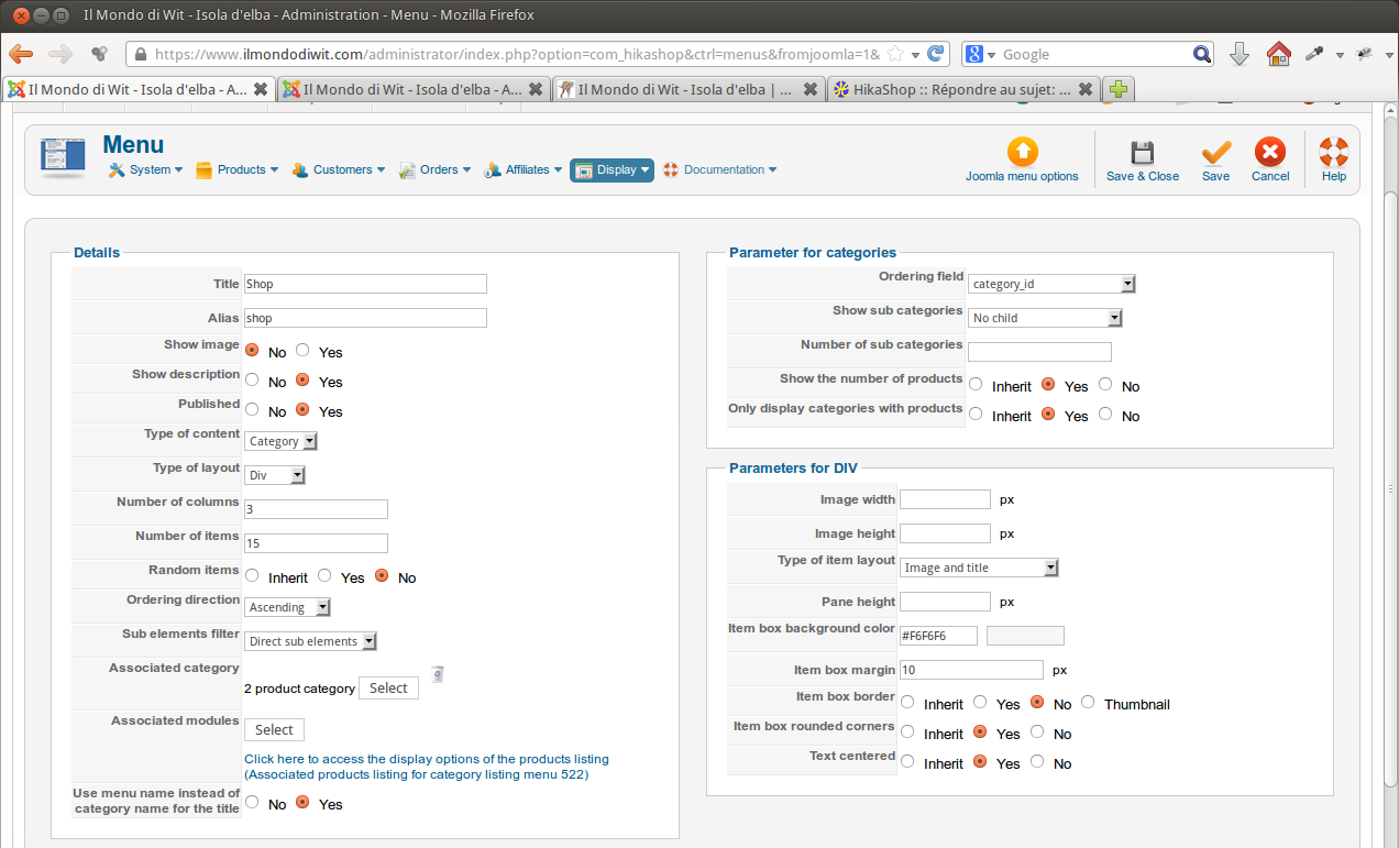

13 years 3 months ago #107765
thanks.
i'm getting a little crazy.
I tried to rebuild my shop menu new cancelling what i did before (and maybe more !?!)
So here is what id did.
Created new menu:
save and click hikashop options on the upper right
save them and then go to the associated module
Now i have a more basic problem !
1. the menu shows casual category items and also the subcategories.
I would like to have the alphabetic order and no subcategorys.
2. No products are shown !
what did i mess up ?? could you please check my atteched settings
Thank you

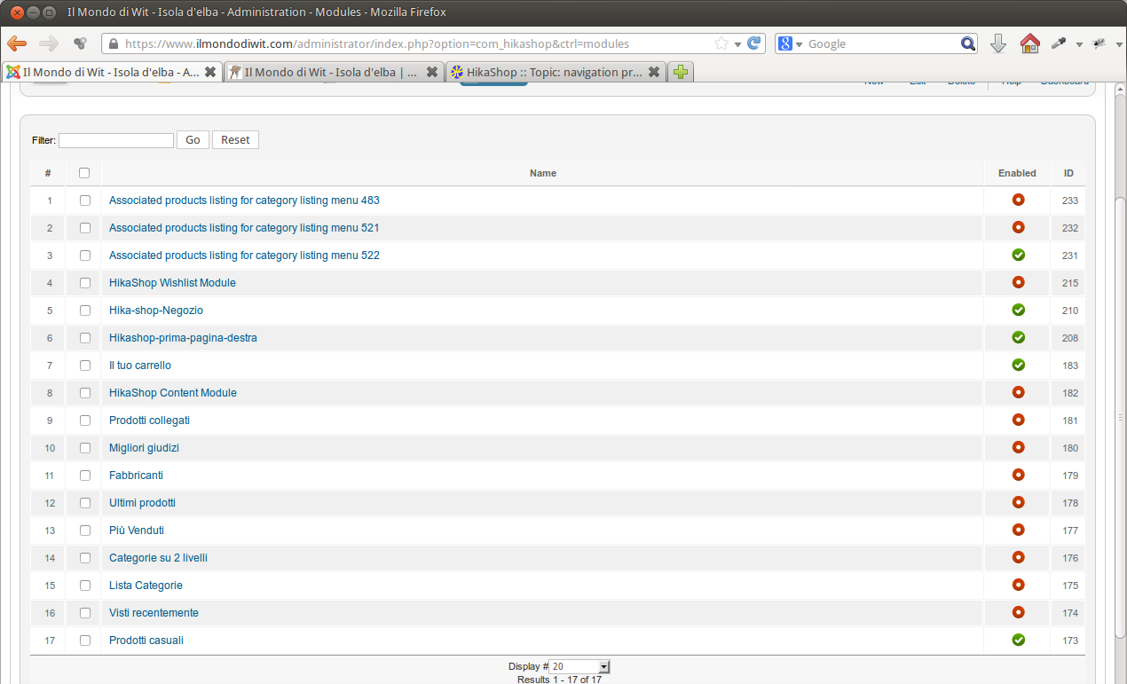

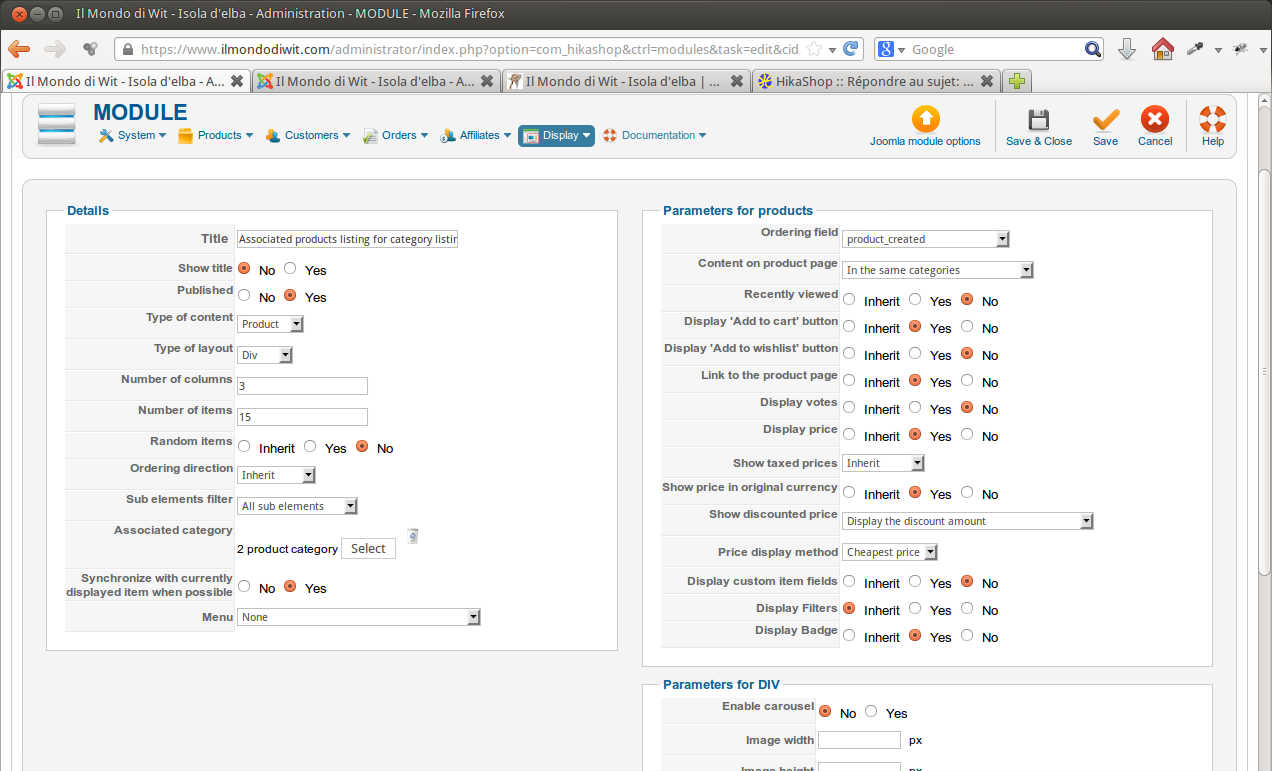

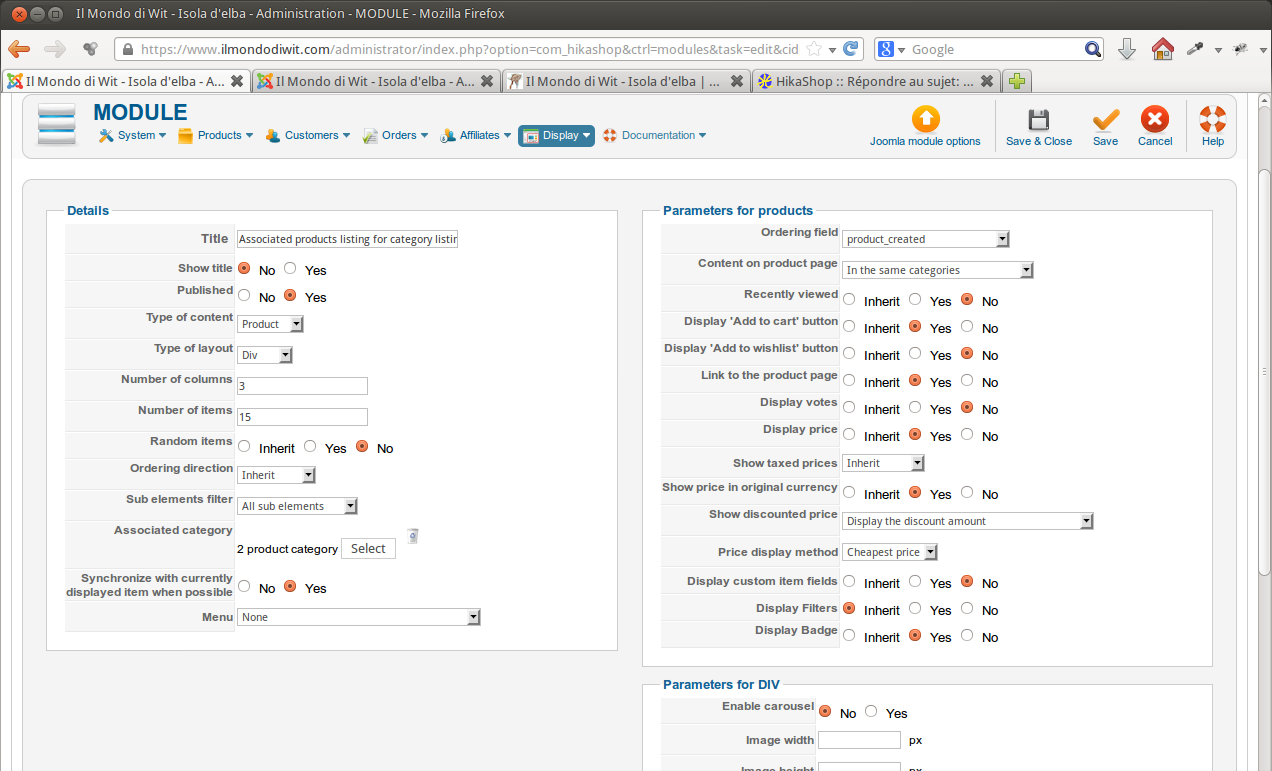

  • Posts: 75
13 years 3 months ago #107774
i attach also modules and menus
  • Posts: 75
13 years 3 months ago #107775
:blink: :blink: Any idea? I looked also extension manager -> modules-> Associated products listing for category listing menu 522 to enable on all pages but nothing?
I don't know why there is no product showing and in which module or menu ichange for example the casual products to no the casual category ordering is still casual. so i cannot understand which element is called by the menu
:sick:
  • Posts: 2334
  • Thank you received: 403
13 years 3 months ago #107804
According to your screenshots your menu shouldn't show the subcategories since you selected the option "direct element".
Could you give me a link to your website please? I'd like to be sure you are looking at the right menu

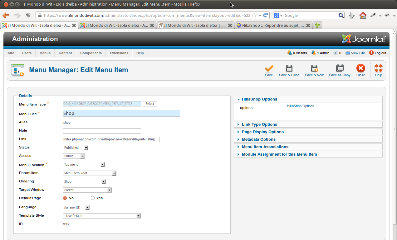

  • Posts: 75
13 years 3 months ago #107809
  • Posts: 75
13 years 3 months ago #107810
it should be menu id 522 isn't it?

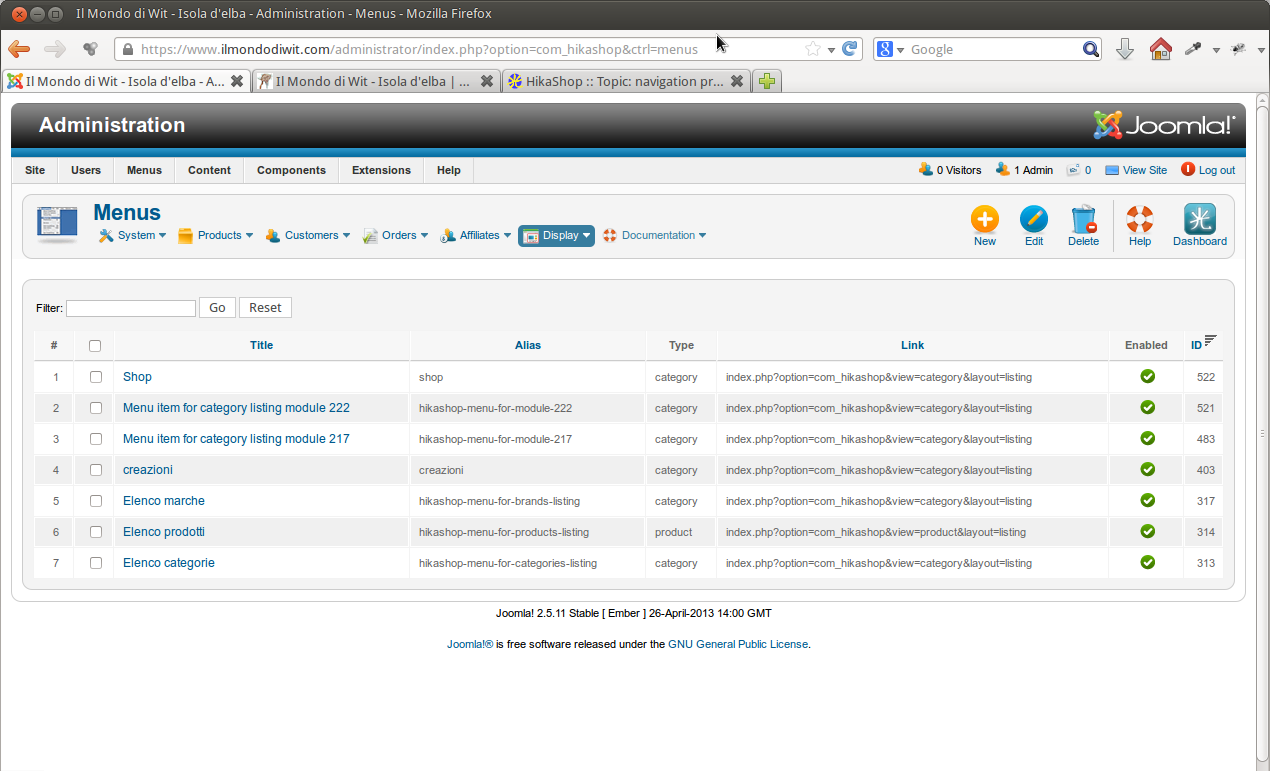

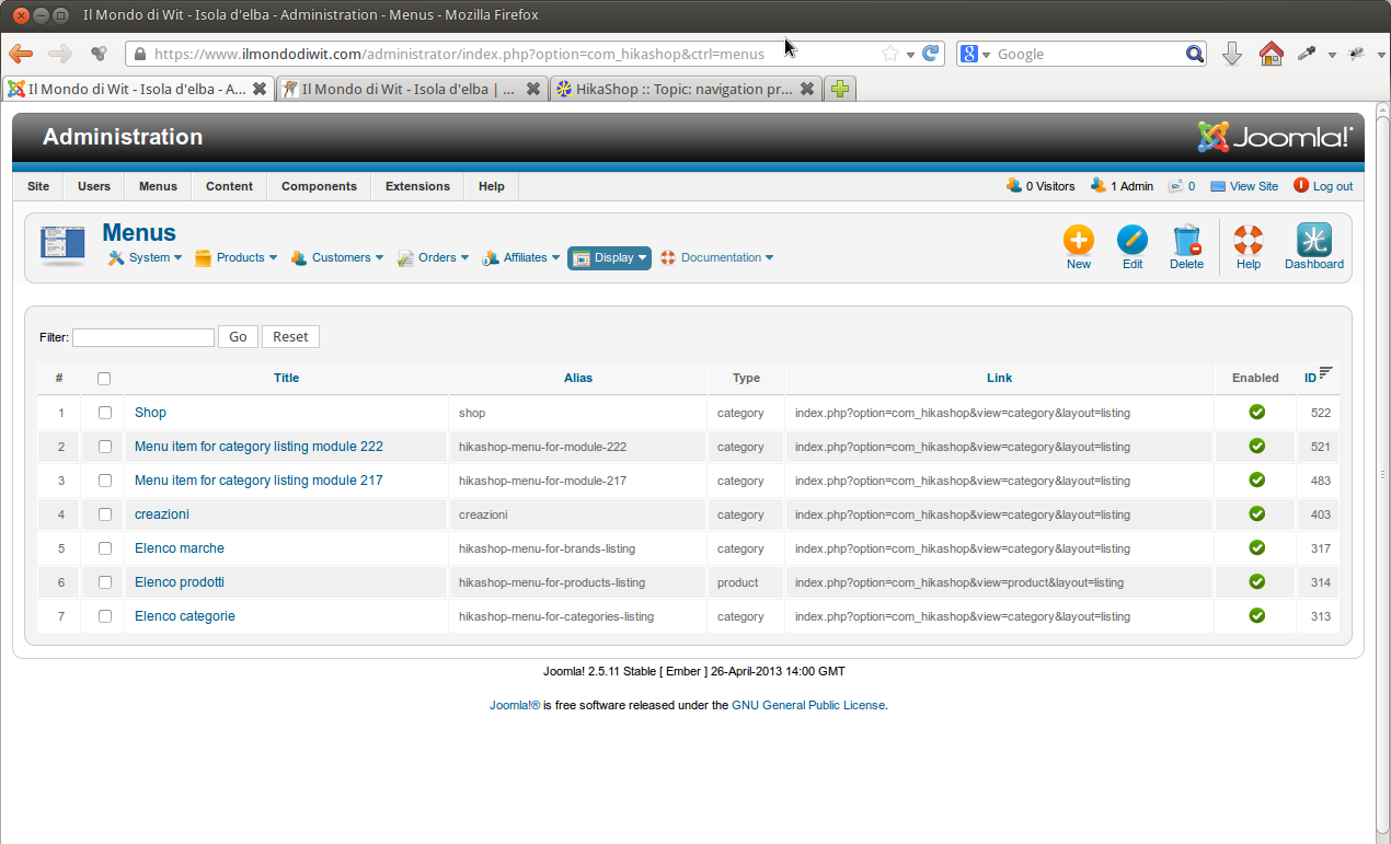

  • Posts: 2334
13 years 3 months ago #107829
It looks like your menu doesn't have any ID...
Maybe you deleted the joomla's menu related to the Hikashop one, well it's quite strange.
Try to create a new Joomla menu and a new hikashop menu in it. I never saw this problem before so it should happen again.
The following user(s) said Thank You: kubwit
  • Posts: 75
13 years 3 months ago #107838
ok. no it seems to work. strange it was exctly the same i did to make a new menu.
Now it remains the problem with sorting of the category in alphabetical order.
in System -> configuration -> display -> Default parameters for categories -> ordering field i put the value category_name
And also in the hikashop menu setting but it goes by category_id
  • Posts: 75
13 years 3 months ago #107840
ok now i got also the ordering issue.
Thanks for your patience.

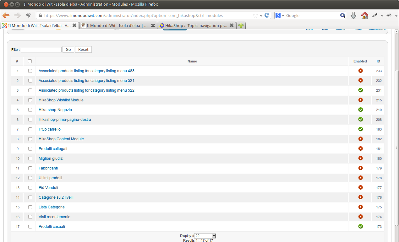

The modules have to be unpublished right?
With my testing around i have a lot associated and menu modules. Should i leave the or can i cancel some of them? if yes for cancel what do i have to control?
