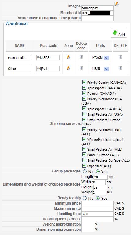

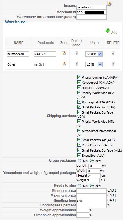

I've decided to set up my site with the starter version of hikashop just to make sure I can figure everything out before I upgrade to the business version but I cant seem to get the Canada post shipping plugin to work properly.
I called canadapost got my merchant id, enabled the canadapost plugin and added weights and dimensions for the products but shipping options still don't appear when I go through the checkout.
I've attached a screenshot of my set-up and the website is www1.mumshealth.com the products page is here
Any help is appreciated.

I can see that you have another shipping method configured. Please deactivate the other shipping methods and you will then see the error messages coming from the Canada Post plugin during the checkout and that will help you fix the problem.

I disabled it and all it returns is "No shipping method found".
I'm starting to think it it's a problem on the end of Canada post. I've called them twice and both times they told me that they sent me an email that would help me set up/activate it but I haven't gotten anything yet.

Have you configured shipping options with CP? If your delivery options in Hikashop don't match those in the CP configuration, you could get that message. There may be other config changes that will help.
The access you need for this is through the CP program called Sell Online (the user name is the your merchant ID). I don't recall the details about how I got that account set up, but I usually find them helpful over the telephone.

I've done some test through your website and it seems like your server is not able to contact the server cybervente.postescanada.ca on the port 30000 using cURL or is redirecting your request though another port. So I invite you to contact your hosting company to check with them that such connection is possible.If the port is 30000 closed, or outgoing connections forbidden by a firewall, your server won't be able to retrieve the rates from CanadaPost.

I've double checked my CP configuration and it is the same as my hikashop settings. I actually saw your topic a couple of weeks ago when I was trying to figure it out myself but I couldn't solve it.
I'll contact my web host and ask them to unblock port 30000 hopefully that will solve the problem.

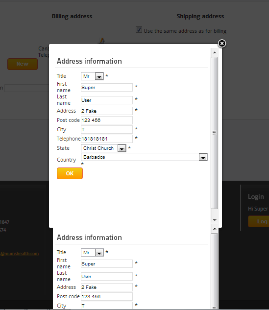

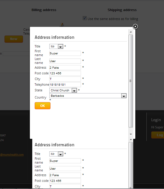

Also I thought I'd bring up something that seemed a little odd. Not sure if it's specific to my site but when a user clicks the edit shipping info button 2 iframe windows pop up, and the second one is cut off.
I removed
class="modal hikashop_checkout_<?php echo $this->type;?>_address_edit"
from address_view.php and it solved the problem but I was just wondering if this was intended.
Last edit: 13 years 2 months ago by MumsHealth.
